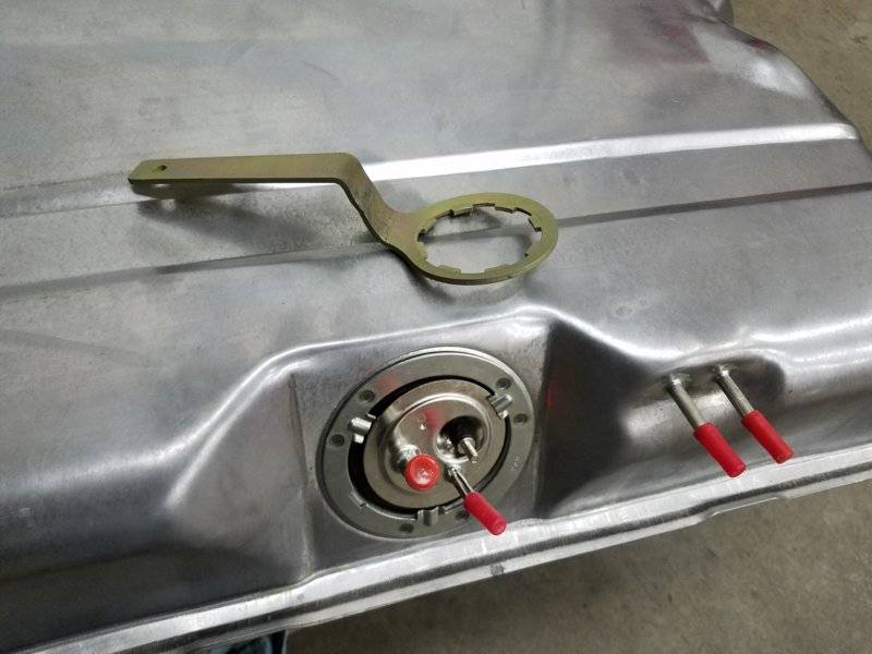

Yep, but the sender will still turn on you as the ring gets nice and tight. Why you need to look in the tank after you'd done.. and then on the next try start crooked in the opposite direction so the tightening brings it straight!You have to get yourself one of these tools Wayne. So much easier to get things lined up and straight.
