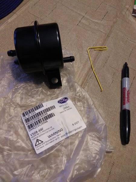

I got a Goodmark one off Ebay a few weeks ago and it has the correct size return port(I anticipated brazing it up and re-drilling, so it was a pleasant surprise). Don't know if it has the screen inside or the tubes at the correct depths...
Part # GMK213126966, was about $35

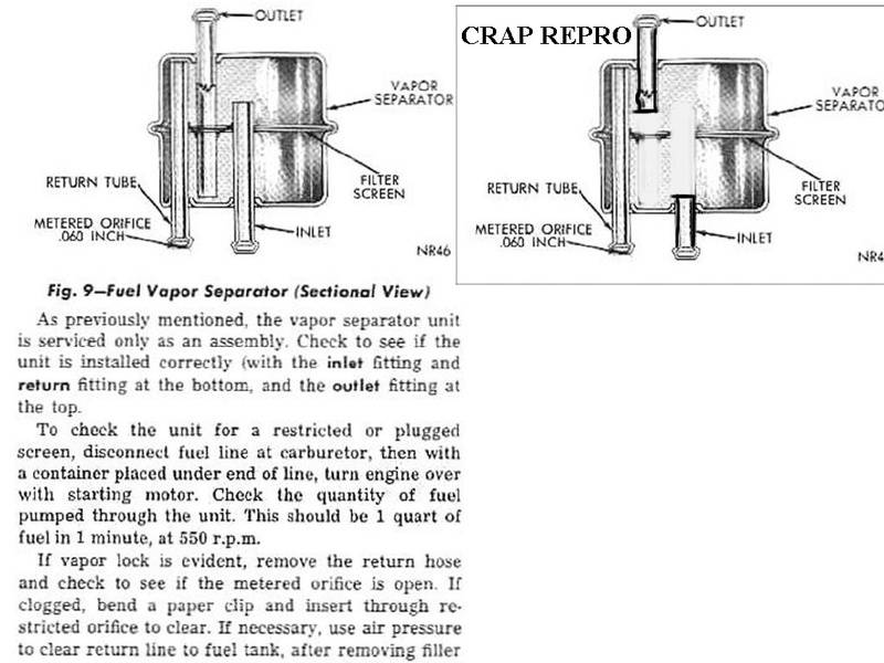

Thanks Grabber... I saw those online too and thought about it a little bit. I think you could stick a zip tie/welding rod/coat hanger down the outlet hole and see if you can "feel" the end of the outlet tube. Here's what I've read about "some" repro fuel separators:
1. Outlet tube is too shot & doesnt extend to nearly the "bottom" of seperator (see diagram below). The vapor seperator wouldn't really work too well like this.
2. No screen - not a problem if you have an inline fuel filter and/or use the brass carburetor inlet filters
3. Hole too Big on Vapor Return Line - you can solder it up & drill it. The best I've seen is to make a .060"-.0625" lengthwise hole in a piece of 1/4 metal rod and splice that into the vapor return hose (or something similar to make a "hose restrictor" rather than fooling with the fuel vapor seperator itself...just easier)
So Grabber, can you determine if you're Goodmark outlet tube goes nearly all the way to the other side of the fuel seperator like in the diagram on the left? THANKS!

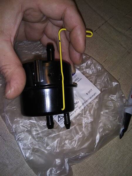

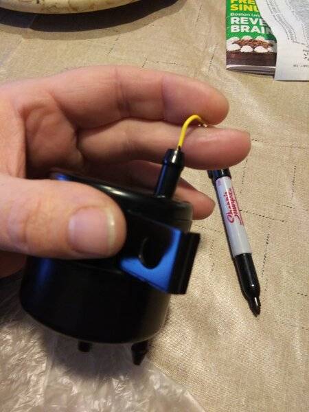

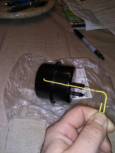

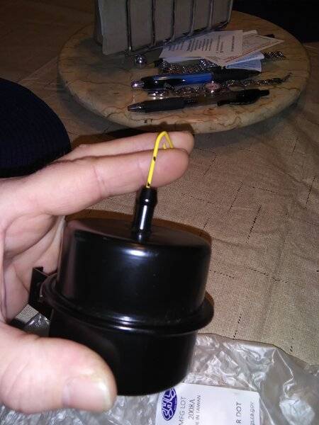

You peaked my curiosity so did some investigating...
Here's the results.
Straightened a yellow coated paperclip and put a small hook on the end to catch the bottom of the tube.
Next, inserted the clip in the outlet tube and hooked it to the bottom of the tube and marked it with a sharpie.
Measurement looks like its pretty close to the bottom. The pic is a hair deceptive.
For kicks I did the inlet tube as well
Everything looks good and I have a filter so not super concerned about the screen, but I do bet it has one...
Here's the results.
I just did this to the one I bought from 521 restorations, and came up with the same results.
I'm just glad to see some of the companies that repop these are getting the darn things correct.
Honestly I'd have been pissed if the tubes weren't correct because it definitely would not have worked at all. I have never seen or ever saw the issue discussed about the tube lengths until I saw the diagram posted by purplebeeper. I'm not saying it hasnt, I've just only ever heard of the return port issue.
Hope this post points somebody twords some simple checks on their new, reproduction vapor separator to prevent mounting/using a product that wont work the way it was designed. I can only imagine how PO'ed someone would be chasing all kinds of issues if the separator was made with the wrong depth tubes...all over a $25 part...
