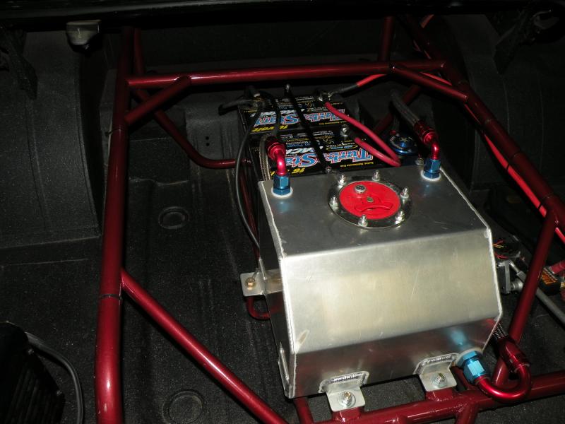

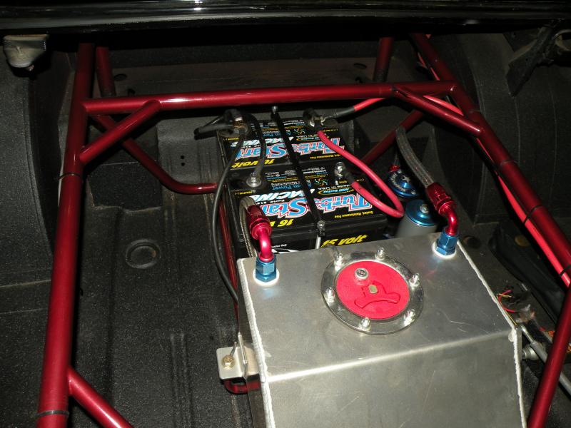

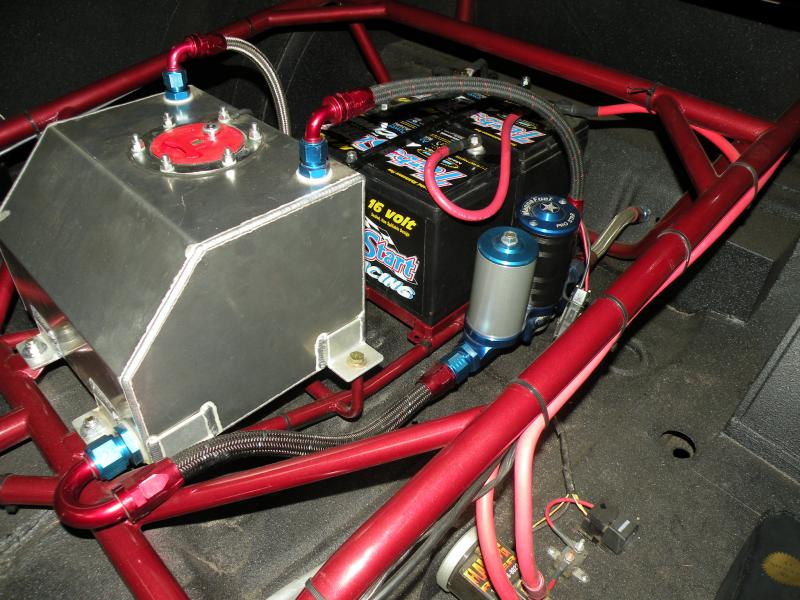

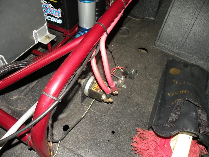

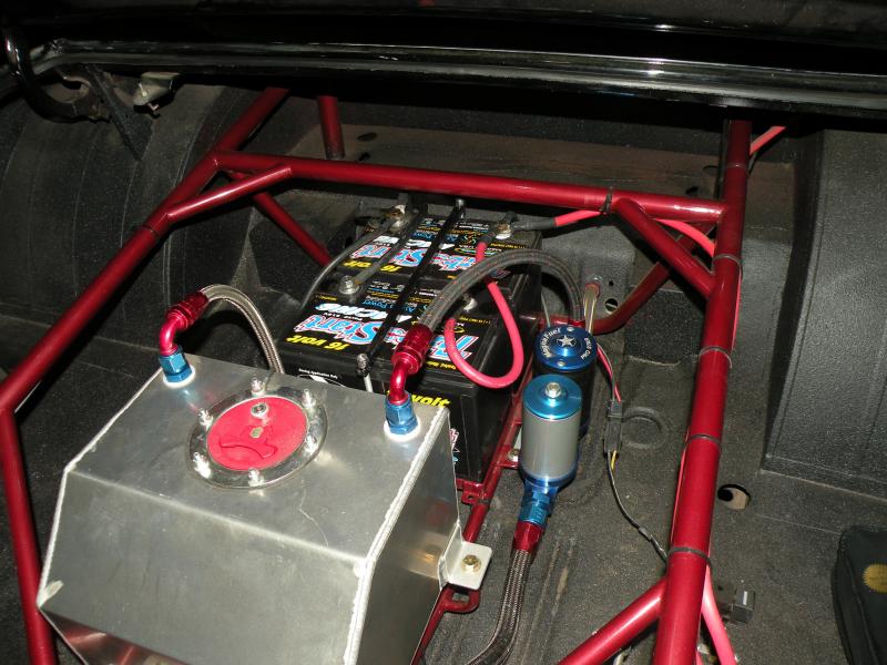

Skinnykid race cars did this one for my black dodge. check out the craftmanship on this 25.5 chassis setup. perfection.
that is perty

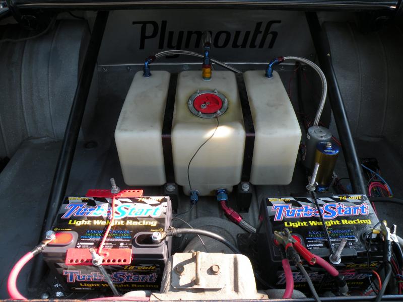

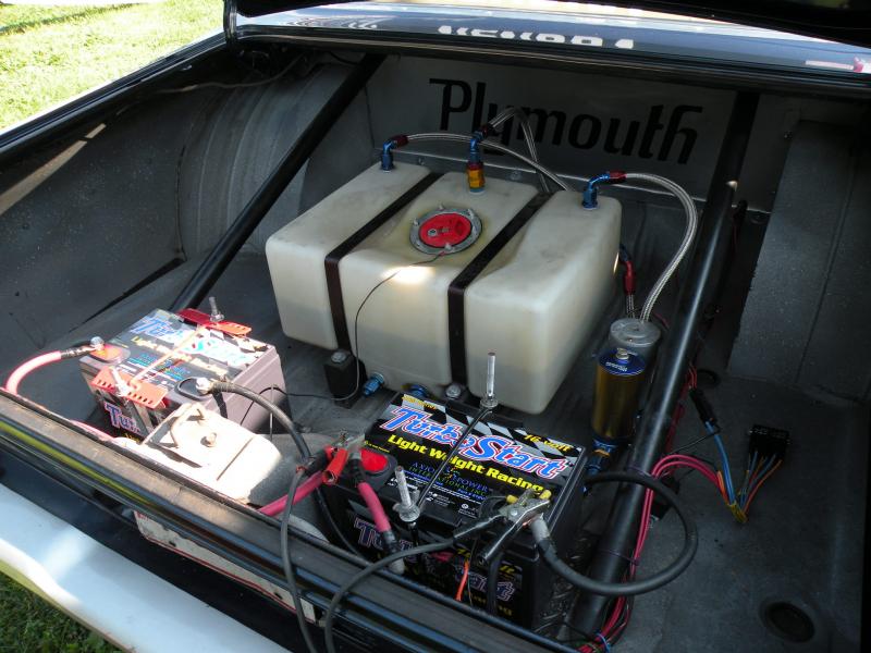

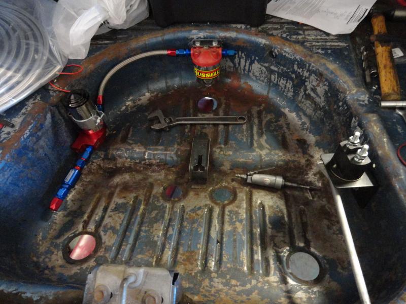

I mounted mine over the spare tire well with the pump and filtrers mounted below the sump so there is no problem with priming.
