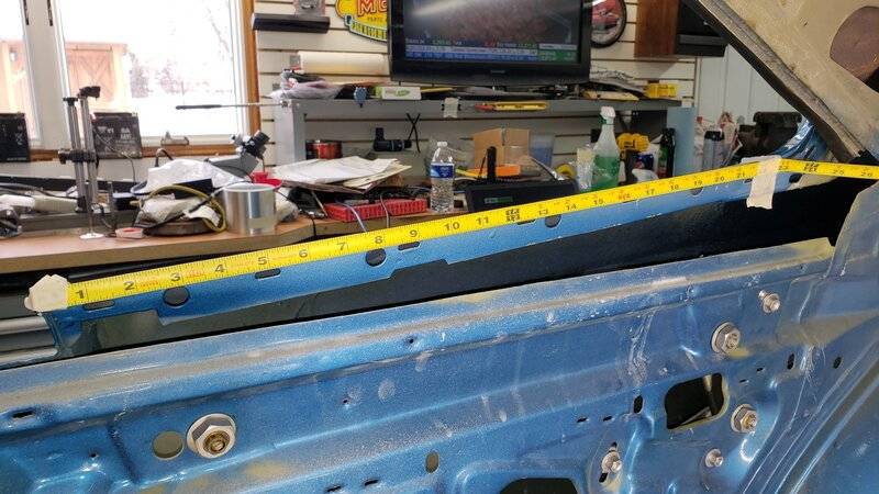

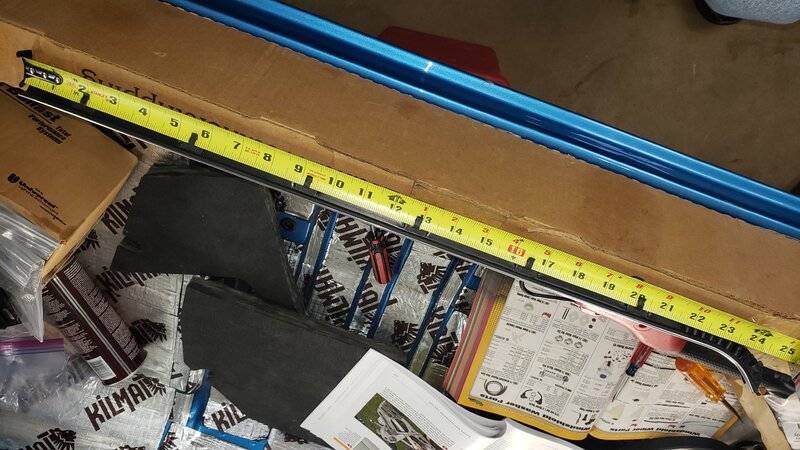

I have a 68 GTX and need both inner and outer strips. A long time ago, (really) I bought a whole weather strip
kit from SofSeal. In the kit were a set of PUI Windowfelts. They look beautiful but when I tried to install them
the other day I found that the clips were not in the right places. I called them and they are looking into the
problem. I also sent them pic's of the strip and my actual edge of the quarter window and location of the slots.

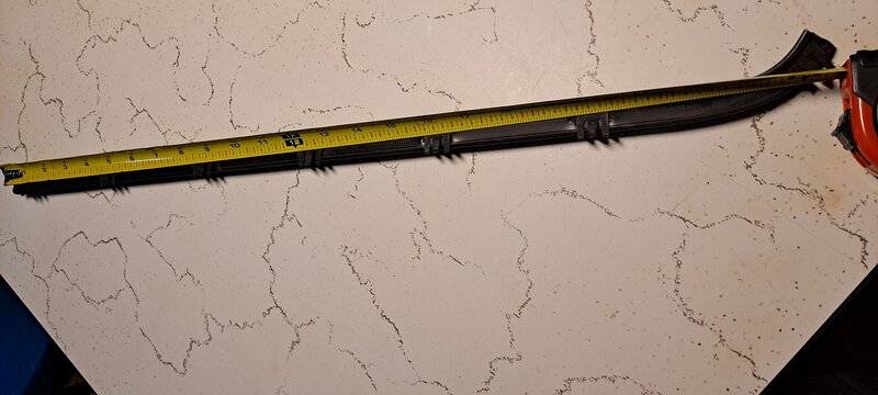

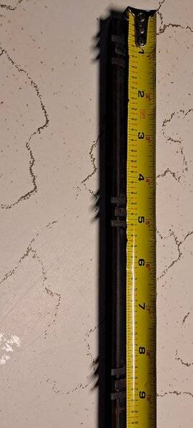

@zyzzyx, here is two pictures that will hopefully help you with the issues that your experiencing. The difference between the Dodge and Plymouth hardtop felts is that the length of the of quarter glass felts. The doors are the same except for the Chargers.
These are the 68 to 70 Plymouth B-Body hardtop outers.
