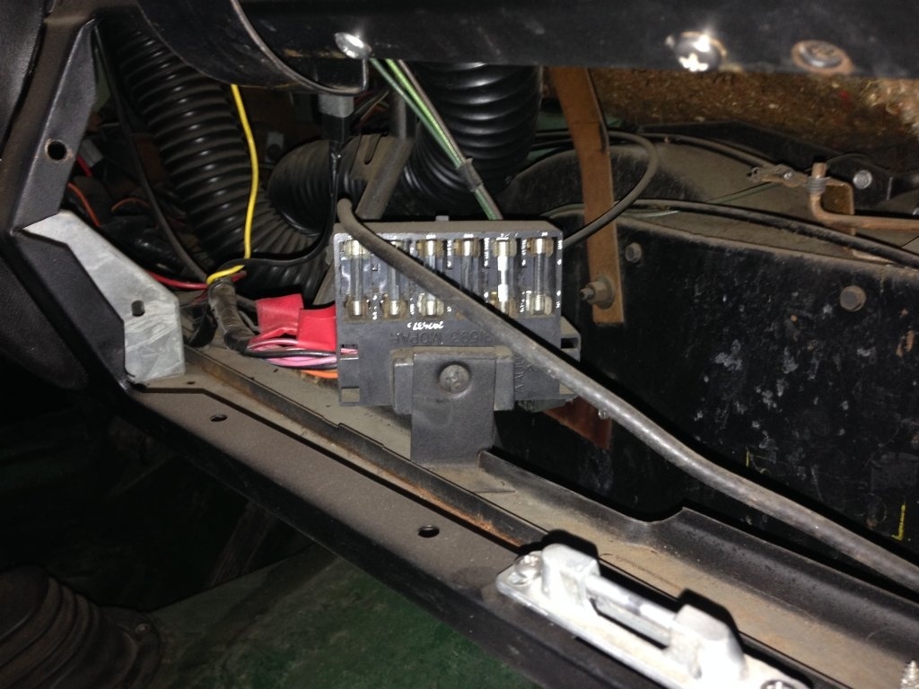

Could some kind soul post me a picture of the fuse box and exactly how it mounts. Inside the glove box or outside, Im lost. Also some pictures of under the hood wiring would be a big help. I have a 69 Satellite. Thanks as always for the help
Here you go Steve. Not sure how the glove box works around it as I don't have one. But it is mounted on a permanent bracket that is angled. 69 rr
The cardboard glove box insert has a little "trap door" that you pull back to access the fuses. (fuses are outside the glove box & behind it). Also, if you have a "speaker cross-over" (not sure on it's name, it's a 3" x 3" x 4" 'ish silver metal box) it is screwed in place on top of the cardboard glove box insert.
