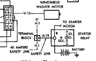

The original harness on my 64 did not have one. I found the the violet wire to the horn relay fried!
This clip from a 64 Chrysler SM mentions a "safety Link" though. H1 goes to the horn relay and A1 comes from the ammeter and a circuit breaker on mine.
