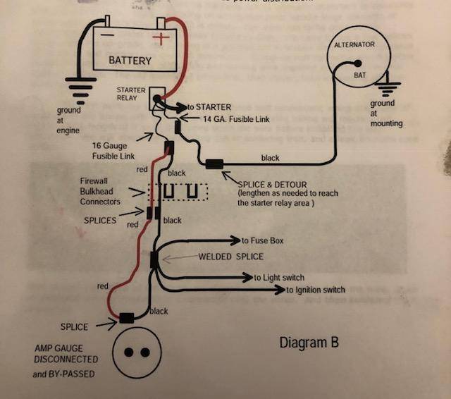

I didn't follow the MAD bypass schematic to the letter.
They "looped" the ammeter wiring. I used a 10g wire to power the interior and left off the "red wire".
