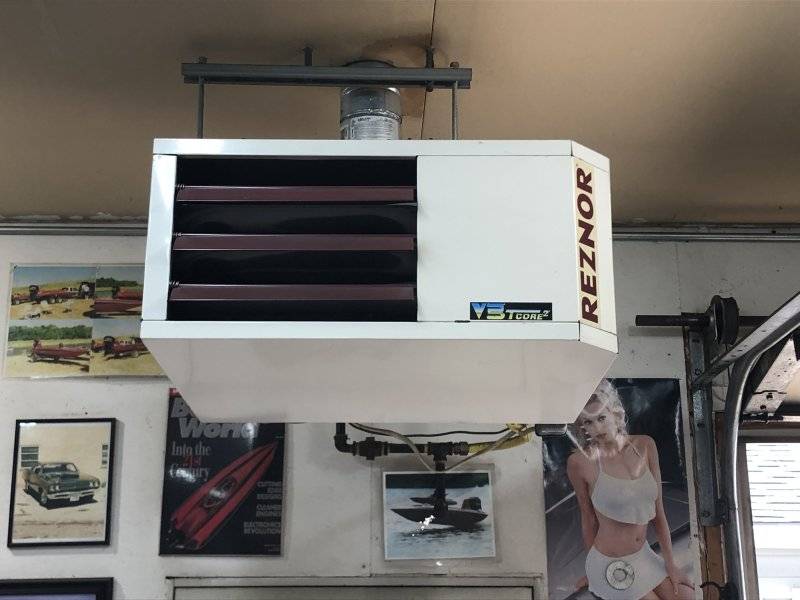

This works great in my 30x30, 9.5 ceiling
A few years back we had a record low of -33 and it still cycled like normal when even the house furnace was struggling
