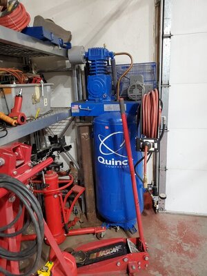

Buy American when it comes to compressors. Bigger is always better. This is mine I got about 11 years ago. Filters and oil changes and it runs everything with ease that I have thrown at it. Even an inline file. I should have spent a few hundred dollars more for the big 7.5HP they had at the same time but I cheaped out. Those with 3600 RPM motors will also have larger flywheels so they turn the pump the same speed as the 1800 RPM motors as far as I remember.

More people say the same thing as Sloinker said! "I shoulda got the 7.5HP compressor". AND an 80 or 100 Gallon tank AND Vertical to save space!

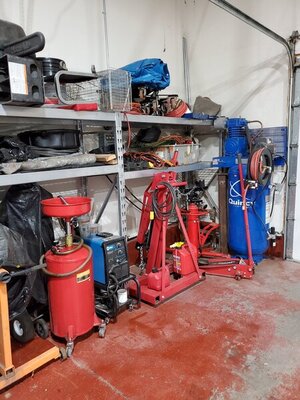

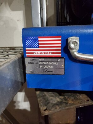

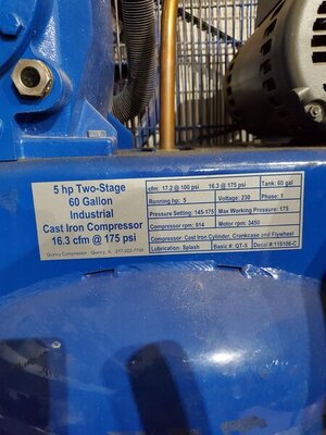

A lot of 7.5 horse are built that way. You will never be sorry you bought a qt-5 quincy, or a champion that runs the pump at less than 1000 rpm. They last, and resell when you are done with them. If you have the money just do it, 80 gallon qt-5. If you ever have to move a flatbed service will do it no problem, and moving companies do it all the time.

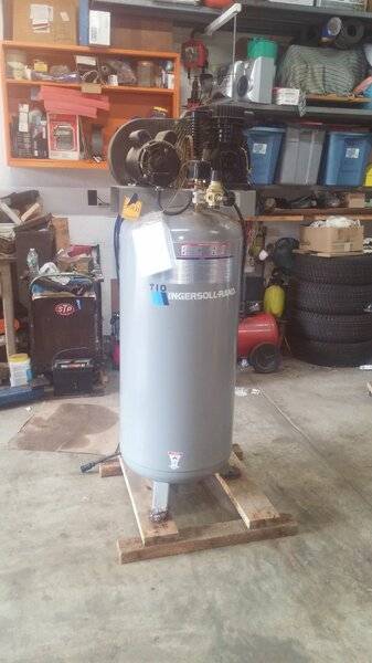

Well, I had my dog out for our morning walk Saturday, and there was an estate sale around the corner. I decided to pop in quick to see about any tools up for grabs. Tucked in the back, under the stairwell, was a 1990 Ingersoll Rand, T10, 5hp, 60 gal unit. $356, as they had 25% off, last day of sale, some help from my cousin, and we pulled it about a 1/8 mile, down the road, on a quick set up cart ! I just need to wire it up, and give it a try. Doesn't seem like it had a lot of usage, as it's pretty clean for a 30 yr old unit. I'm hoping it will do for now, and will let you all know. THANKS to All that responded in this search, and Stay Well. Hope to see most of you at Carlisle in July, at the Tent !
Great buy, put a big fan on the pump when you sandblast, keep the oil changed and it will hold up well.
