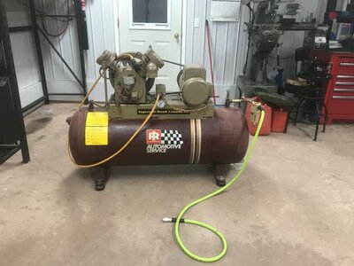

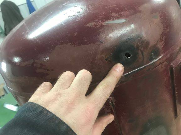

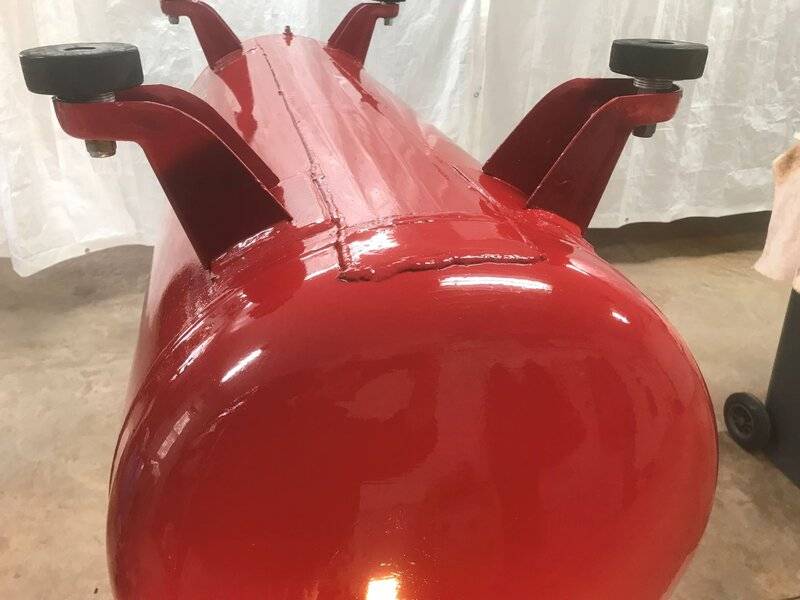

I just went through the same thing. They wanted 1700 for a 80 gallon tank??? Took it to my local welding shop and fixed the pin hole than put a whole new bottom over the top of the existing tank. Pressure tested it a 180 psi good to go. Yeah I know your "not" suppose to weld a high pressure vessel, but mine was a pretty heavy tank. A oldie 1979 IR. Don't make them like that anymore. Did the valves over when I had it all tore apart. Went from 14 minutes to 5 minutes from 0 psi to 130 psi.
