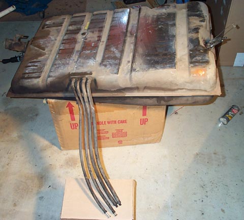

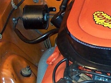

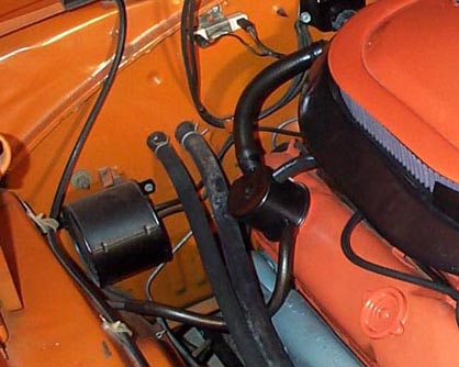

My car's in storage right now. My original rubber ECS lines started leaking a few years ago, had to remove the tank to replace & took a few pics so I could duplicate with new lines. Here's some of the tank & ends-

Thanks for the pix. I'm still not getting the clear picture here. With the rubber line coming from the breather, is there still a vapor canister by the fuel pump. And does the rubber line coming from the breather go straight to the gas tank somewhere?

The line from the breather goes to line at the right quarter panel, it's the one that still has a hose on it in the 2nd pic above. There is actually a sheet metal cover over the lines which is removed in the pic.
The return line from the vapor canister (by fuel pump) goes to the sending unit on the gas tank. If you look closely on the 1st pic of the gas tank, you'll see 2 lines from the sender on the right. Again this has nothing to do with the ECS, non-CA cars with 440HP/ hemi have this.

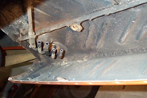

Finally crawled under my RR yesterday. Found 3 lines coming forward from the tank area. All 3 went as far as the pass floor board. 2 were snipped & only the fule line line continued. Looks like i need to replace the fuel vapor line & the emission line from the breather to the ecs port on the gas tank.
