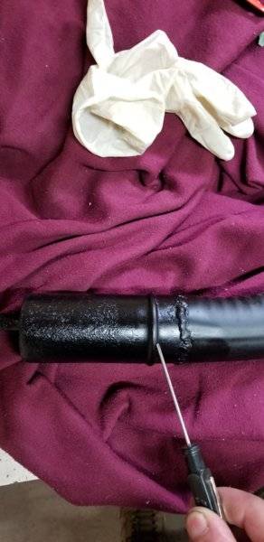

Sounds like I will need to order the more expensive one from steel...I took a closer look just now... Should I be sitting it in past the lip pointed out in the photo or just up to it like I had it?
the filler tube goes all the way up to the lip. I bought a 7.00 grommet off eBay with excellent results
