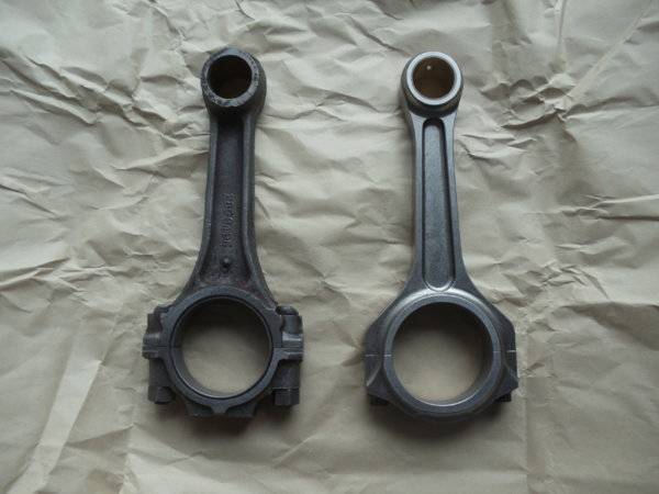

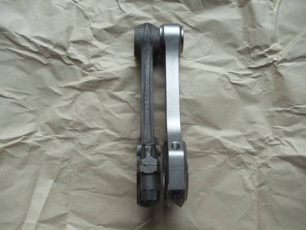

I guess there is no way to manipulate the laws of physics. I'm running a 318 two barrel right now, converting to a 340 shortly, then I am going to de-stroke the 340 to a 305 (billet crank should be ready in another week or so). It should be interesting to compare my MPG figures and see which is more efficient. What may throw the whole comparison off is not changing the rear end ratios to match torque peaks of each motor.
My custom (longer) rods for the 305 are ready to go (see fotos):
View attachment 541088 View attachment 541091
