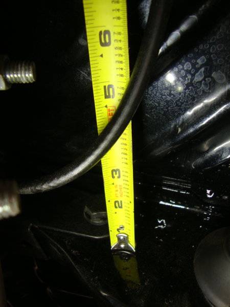

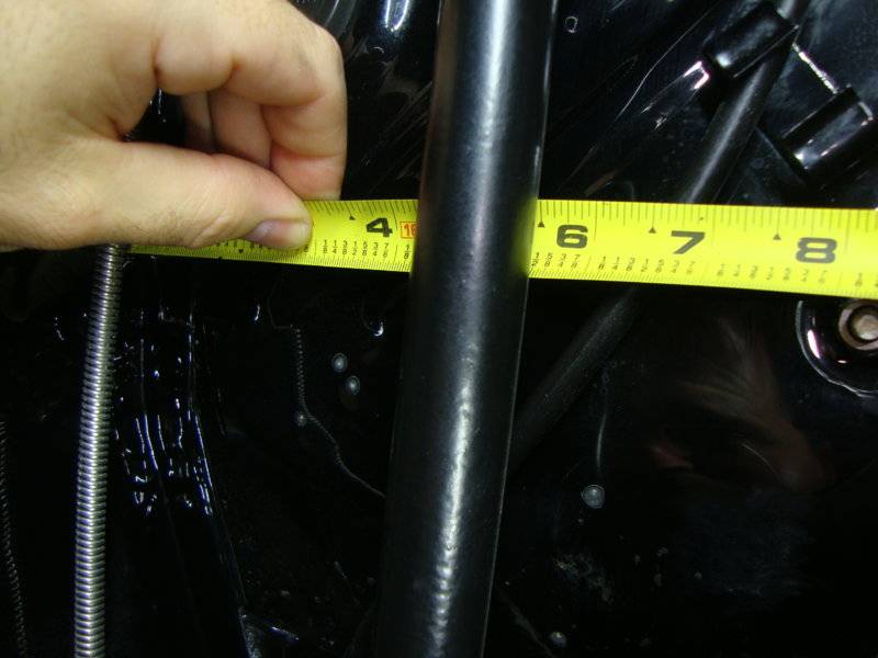

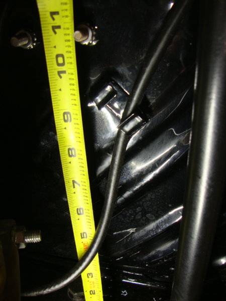

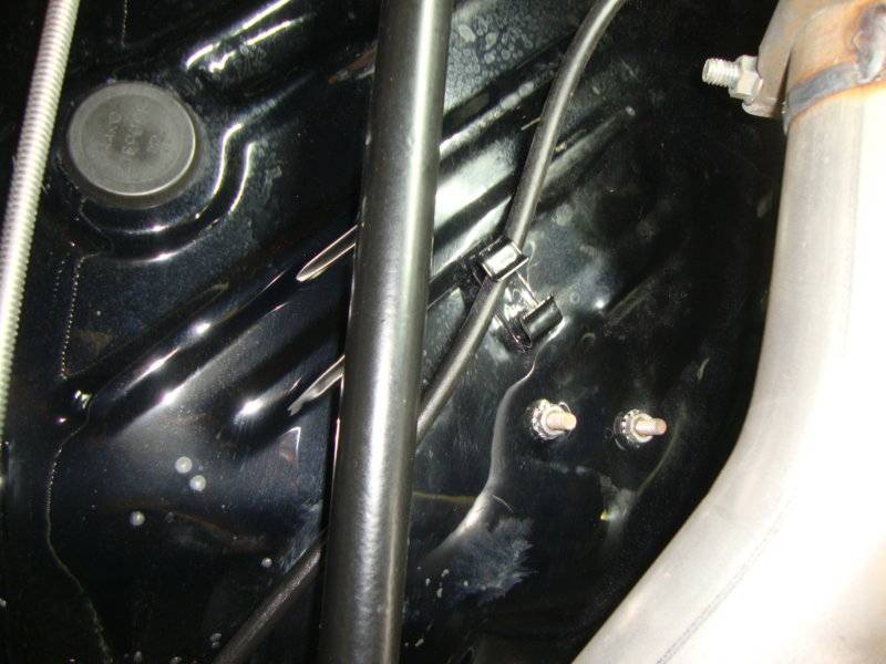

Finally, found my reference....Enjoy...
Gas Pedal
1. Outer hole(towards driver door) from inside edge of frame rail to center is roughly 8 1/8-1/4(between)
2. Inner hole towards trans tunnel 9 5/8-3/4(between)
3. Both holes from inside of trans crossmember brace are 10 3/4"

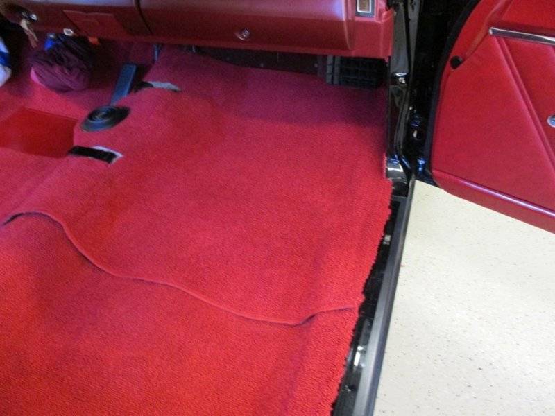

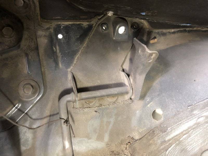

What about the carpeting and the bracket on the fire wall. Does the carpeting go under the bracket, over the bracket, or is it cut out around the bracket?
https://www.forbbodiesonly.com/mopa...y-father-my-69-gtx-restoration.127388/page-53
Also page 54 and 55
I have seen the original carpet cut a couple different ways from the factory. The X was from the LR assembly and I cut mine from examples I have seen from original cars.
A slit was cut from the top of the right side of the bracket to allow for passage of the throttle cable attachment side. Then on the left side a hole is cut to allow the lever arm to pass through for the gas pedal.

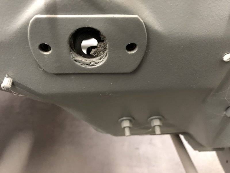

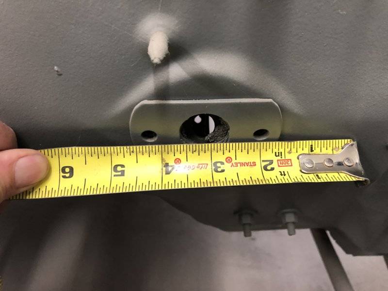

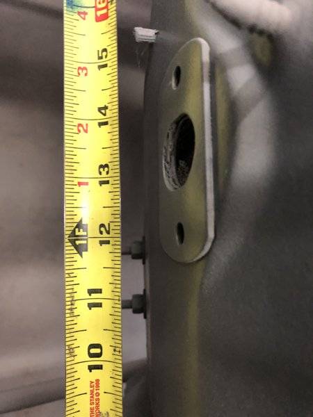

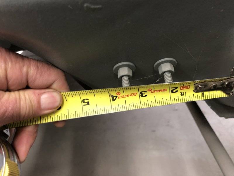

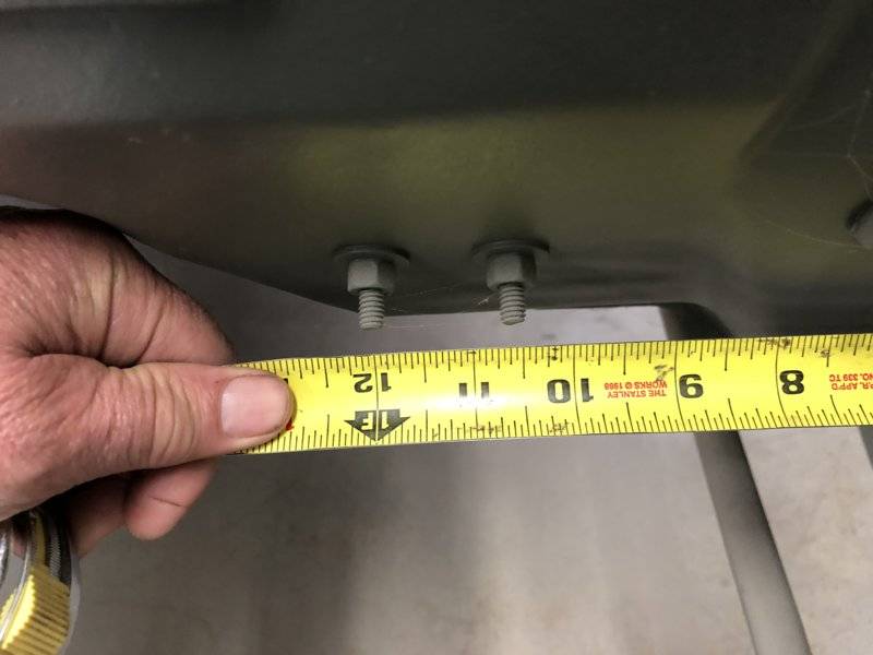

I have never really paid attention to this assembly before. Offset mounting points, top and bottom. Measurements are within a 16th despite what the pics show.
Let me know if you need additional clarification or need a measurement from another point.
Top mounting point, 2 1/4 center to center, 12 1/8 to the outer most lug from the inner fender.
Bottom mounting point, 1 3/8 center to center, outer most bolt 10 5/8 from the inner fender.
A shot from the inside.
