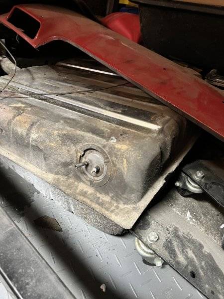

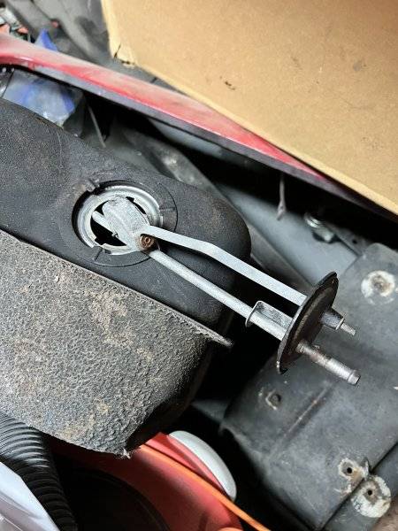

Hi, I’ve removed the retaining nut, and want to remove the fuel sending unit. I’ve tried a light pounding and twisting and it won’t budge. Any tips for getting it out?
Turn the tank on end, soak with penetrating oil, let sit, and give a light prys all around with a screw driver. The gasket is probably petrified.
Just a dried up thin rubber gasket holding it in place. Gently pry on the edge of it with a small screwdriver.

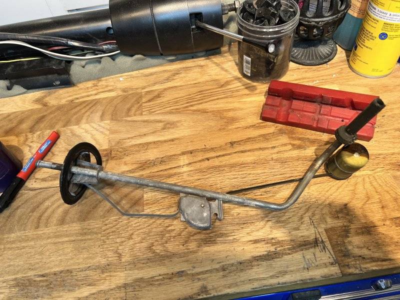

No idea if it was working before I took it out, since the car wasn’t working when I got it (motor and transmission out), and I’m fully restoring. I want to clean the tank out of old rancid gas, and restore the whole thing. Thanks again for the help everyone! Happy Easter!
I see a few fuel sender resto outfits via google searches. Does anyone have a recommendation?
Thanks

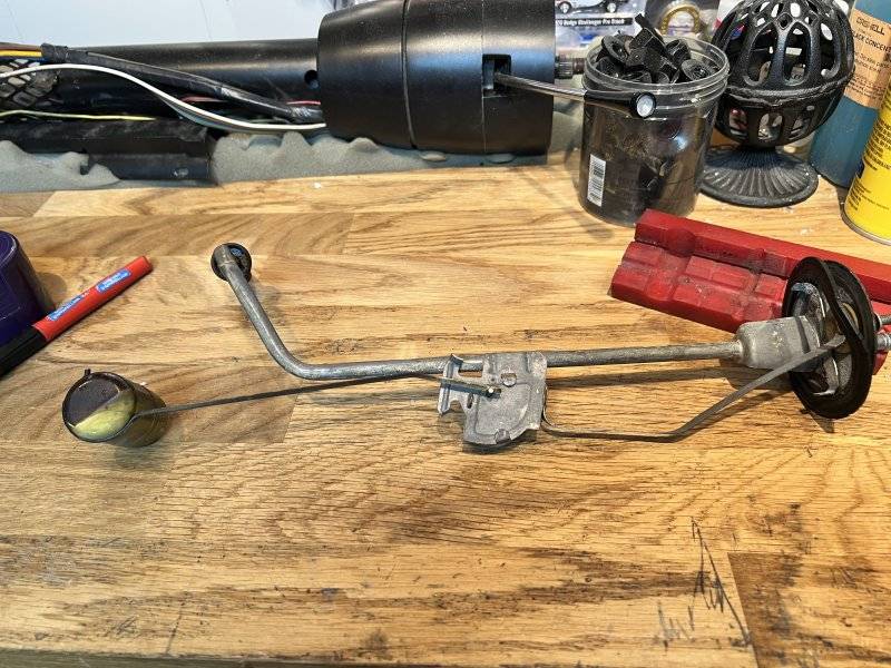

It actually looks very clean, I would ohm test it with a meter, and if it works, just replace the float and put it back in. The ohm rate is 8-77ohms on the full sweep, or thereabouts.
