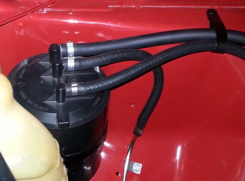

Nice job....Are those cinch clamps? I was in three auto parts stores today for other reasons and ask for some Oticher sp? clamps for some marine fuel hose. I've yet to find a guy who knows what they are. As Trump would say, "SAD".
