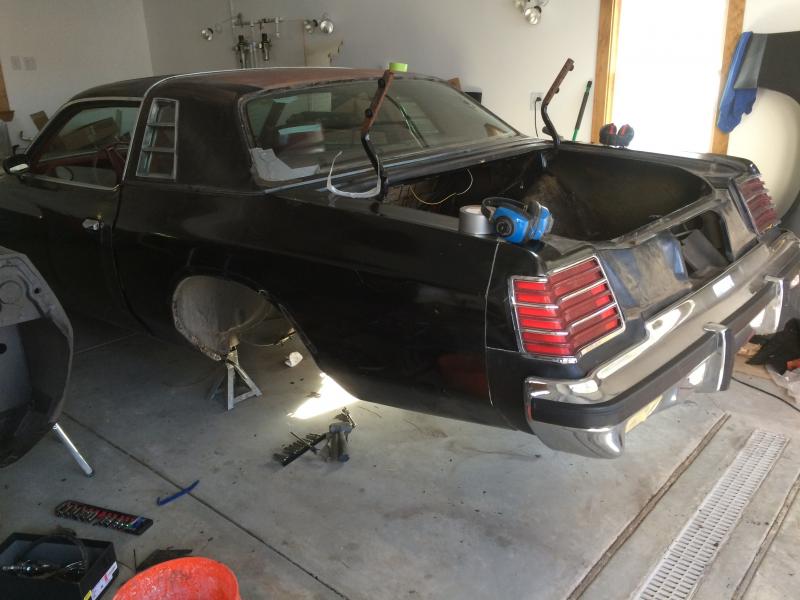

rear section trunk.jpgPulled the tank off my 78 Magnum last month. In general it need replacement. Because the later b-bodies have the hump or bump only with a vent system these new tanks are more expensive but still available. Typically $350-400. My 74 charger has a similar design, but I purchased a new tank for the charger with the intent to mount it to thr magnum for comparison. The neck size is smaller in width and length. So that maybe a minor issue. Ive read reports in the forum that a 75/76 Plymouth works just fine. Also that Rock Auto has the best prices. If you plan on dual exhaust system. the tank is narrower but the fill point is the same. In other words it fits the magnum. If you run a search using forum search options you will find part numbers and a lot of helpful comments. Also the gasket and sending units are available. Just make sure to sent the sending unit drop first before installing tank in your magnum. Let me know how it works, I'm not ready to install the tank just yet. Planning to paint the underside, trunk, interior and engine bay black. Thereafter the body will be black.
