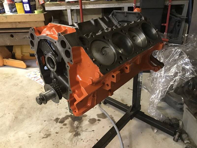

So I am refreshing my motor, it's a 1968 383 motor with a pair of 902 head.
The block look like it was oversize by 0.030" at some point.
I am cleaning the motor and the head only, I don't touch the base or the piston in it.
My question is: What gasket set do you recommend?
I search and Fel-Pro have two set, KS2110 and 2601001 that look identical and I can't find spec for those set, so it's kind of hard to select one or the other...
As for other company, I do not have much experience on this.
This is a budget rebuild, so no, I will not machined the head or the block and I don't want to spend 1000$ to fit a gasket set.
Thanks!

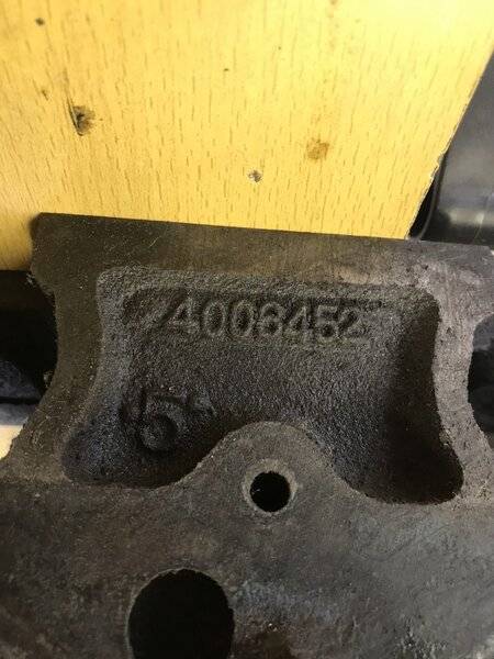

OK I was completely off for the head number...
They are 452 head, I have attached the picture of the casting number.
4006452 – 1976-1978, 400/440 B/RB-series big-block, 2.08/1.74 valves, 81.5cc

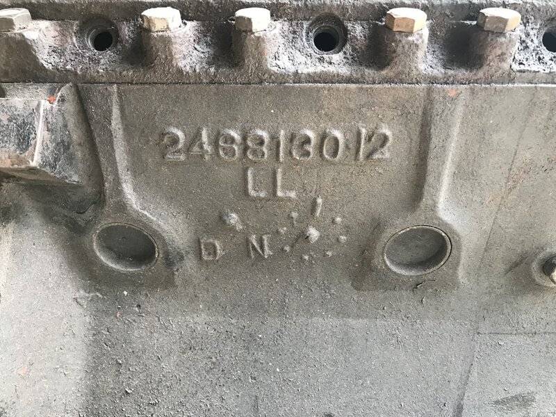

The motor casting number match the year and motor type.
2468130 – 1959-1971, 383 B-series big-block

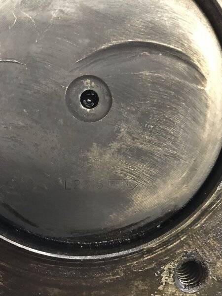

What are the pistons in the motor with the single valve cutout and the center Bolt ?
The reason I ask is my 1970 383 HP motor had 1 piston in #4 that looked like that and the rest were flat tops which I know was added by someone who had the motor apart at some point. Just never seen pistons like that before.
I have no f**king clue...
I bought the car already in pieces and the motor and transmission were at another storage.
The motor was already half open, the head gasket were remove at some point and the head bolt back without it.
There is a "030" stamped on the piston, so I am almost sure the motor was rebuild at some point, so it's probably aftermarket piston.
They are all the same on my motor, but I was not able to find the same piston type on internet. Probably an old model that do not exist anymore...

I would think a machine shop did that. Can you post a better close up?

Yeah I think RemCharger may be correct on a machine shop cutout on those pistons because that looks pretty rough to be produced that way. Also can see it looks like a valve dent on the other side. Did the motor have a really high lift cam in it ?
I disagree. The pistons are flat tops, and the valves crashed. It is possible that someone free handed a valve notch, but I doubt a machine shop did that (unless a hack machine shop did it). I get asked to machine piston tops and valve notches some times, but say I can't as I do not have a piston vise to do the job properly and accurately.
