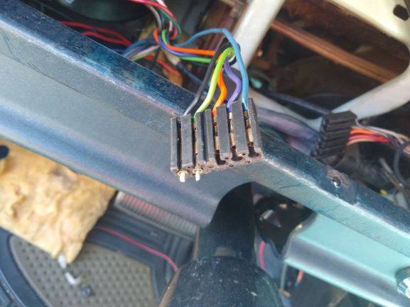

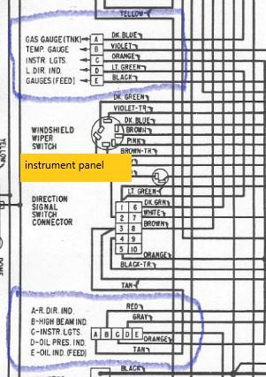

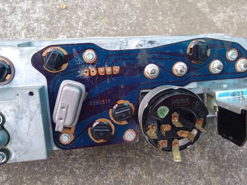

My name is Gene Manley and I am working on a 1966 Plymouth Belvedere , because of the age of the car what started out as something simple ( bad gas sending unit ) has turned into something a little more complex Picture 1 is the connector i need, and i need two, both housing and female pins, picture 2 is back side right pin connector that i will replace and were one of the connectors i need go, Picture 3 is the wiring diagram showing what the two connectors feed ,

Get a Molex 6 pin connector, solder stranded wires to cluster PC board and install in one connector, then attach the new Molex pins to the original harness side, and you now have a disconnectable junction. I think you will be hard pressed to find anything original, let alone easily repair the original pins to the PC board.

great idea will look into doing that found a 5 pin molex flat connectors mail and female pins again thanks
