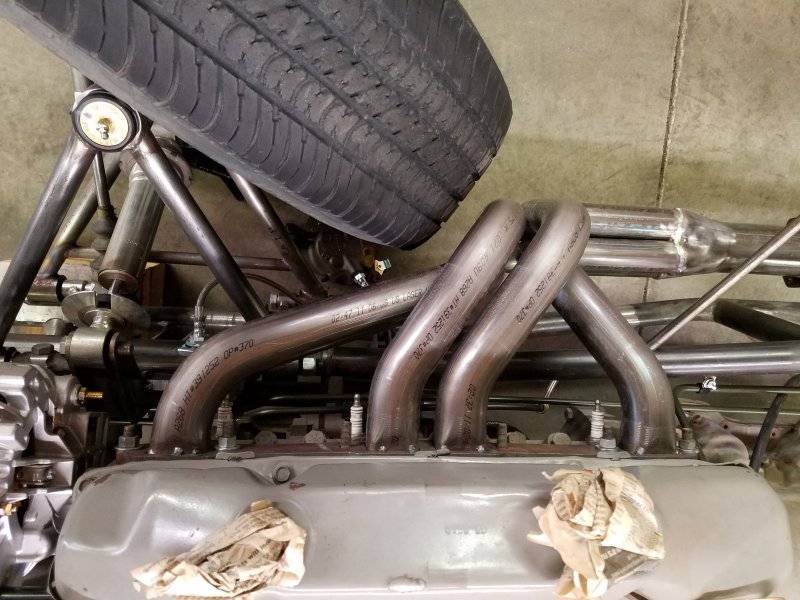

Sorry to bust in, but have you considered
custom? Given you have a mfg nearby?
This set on a custom tube frame 440
equipped cost me $340.00.
PM if you would like the name and
number of the place that did mine.
He did a set for me on a V-8 equipped
Jeep 20 years ago. Zero problems.
