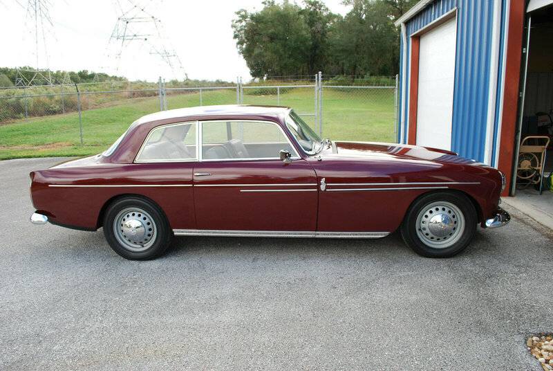

BTW, Bristol were an English handbuilt car company that from the early 60s used Chrysler V8s and transmissions. Here's a pic.

Thanks for the info on the Bristol. Very cool! Sort of like the more famous Jensen, eh?
