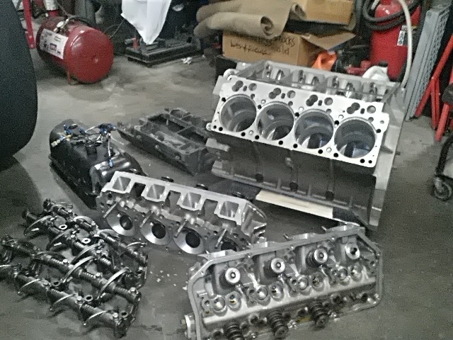

Rolled it out from under the desk today. Very soon at the machine shop. Got a LOT to learn. Block is a JP-1. Heads are Mopar dual plug aluminum. Rockers and stands are stock. Crank is a Crower 5/16 stroker.lol. Aluminum rods,pistons. Gear drive,roller cam. Nothing state of the art but thats okay. Cause it will make good power. Its dry sumped and will be running a littlefield 14-71 supercharger. Methanol for fuel. Not sure what its going into.....

Thanks for the compliment Budnicks. Broke,I can relate to that. But the deal for the parts was too good to pass on. Was very lucky on that one. So far it looks like it will come in at about $ 7-8 per horsepower. Bout 11k total. One reason all my junk gets around on open trailers.lol. Any advice is welcome as I'am not finding much info on this type of motor. Hey I'am still wondering if this takes water or not!

Those heads look the same as a set I have on the shelf. Do you know who ported them? Are there any stampings on the heads??

I checked em out. Douglas Porting Service. And get this,dated 11/12/82! At least it looks like a competant job. Uniform,even,slightly rough,stayed away from the short turn radius. LOL. Will get some flow data and go from there.

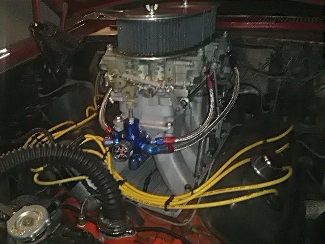

Mega block 200lbs heavier! Come on now! Whatcha got there-the compacted graphite block? That ones heavier because that stuff is heavier than iron. Least thats the way I understand it. For the street I got my 64 belvi. Put an 11-1,solid cam hemi with an Art Carr rmvb t-flight in it in1988. Gave my dad the keys and he drove it for near 20 years. Just changed the oil and plugs now and then. And repaired the deep sump a few times. A few years back I repoed it. And swapped in a fresh hemi. See pops dont drive so good anymore. So now the 64 is set up like a late 70s street racer. 2 carbs,t ram and 2 kits. Hidden,but not real well. Like to get it to the track this summer. If I can make the time for it.

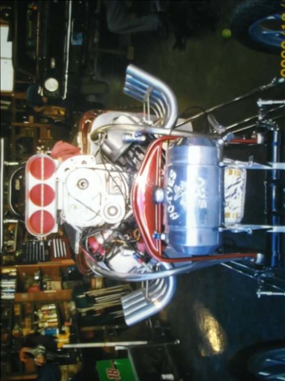

The 23t,how fast? But when someone asks about the racecar they gotta be more specific. See I run a big block dart. My high school car. Back halved car I'am always playing with. 32bantam nostalgia altered. Blown,injected 392 on gas. The crank sits 2 feet off the ground. Another 23t altered. 540" big block chevy injected on methanol. I wrench on this one now and then also. And the big car,23t. Ya know I only been down the track 5 times in it. Its hard to get help to run it. Need at least a 3 man crew. Straped in real tight,barely able to move. Its quite the experiance and not for most people. With so little seat time every pass is an easy one just to get it down the track.lol. So at 11% over on the blower and a safe tune up its gone a 1.288 60',5.247 @ 135 at the eight,8.309@161 quarter. Another pass 1.286 60',5.164@143 in the eighth,8.188@134 at the quarter. Driven a bit harder the 60' should be close to 1 second flat. The eighth in under 5 and well into the sevens at close to 175. Then I could start leaning on the motor. The fuel pump is good for up to bout 30-35% over. We will see. Next test n tune is in july. I can hear my guys already,"its too hot!" What can you do? Thats what I like about doorslammers. You can run em by yourself. Maybe that new motor will end up in the dart. With a slider clutch and a lenco. LOL.
