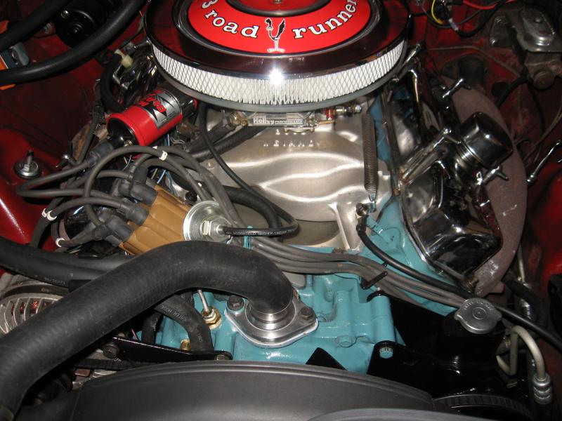

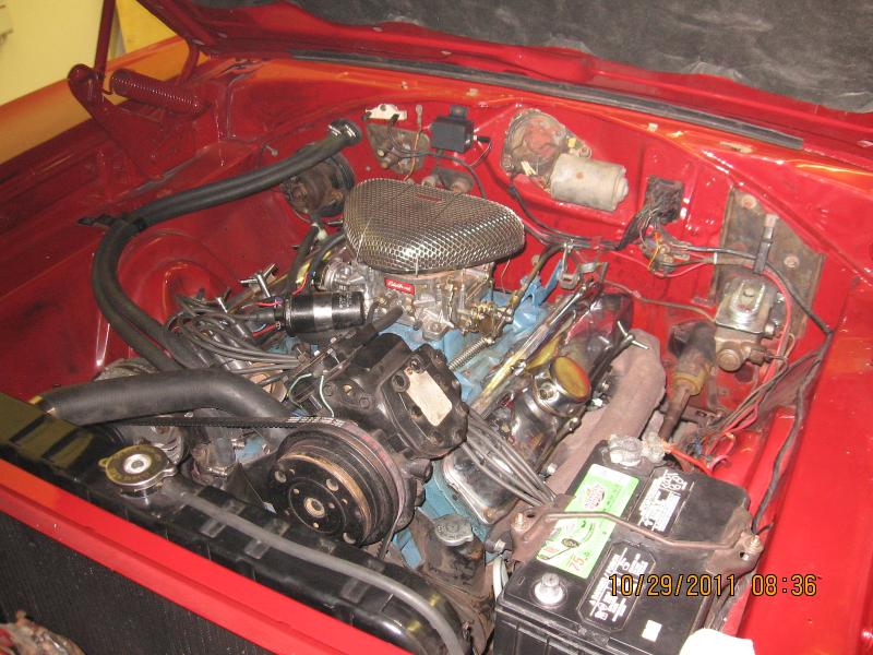

I took mine off and you will need a new crank pulley and new alt mounting bracket as well,I still have dual pulley on the alt but 1 belt.The A/C has a idler assembly that you will need to remove.i bought a new set of water pump housing bolts as some were now to long,you can get the set from Mega Parts.I bought my pulley and the alt brackets from a source on EBay that I dont remember but just did a search for big block mopar alt bracket and pulleys.I also got rid of the flex fan PO had on there and went back to the factory 7 blade fan with a OEM clutch,got them from Tonys Mopar Parts. Beep Beep 013.jpgBeforeIMG_0493.jpgafter
