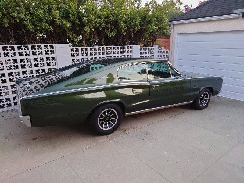

Well a big milestone was met yesterday. After many days of work, the suspension has been rebuilt - what a job. I lost count the number of times I complained about the cost of parts and wondered what Chrysler engineers were thinking. But here it is. Front disc brakes are installed. The rear spacers really improve the look of the car.
I found some loose ball joint nuts, a brake hose that was ready to pop, and that the rear diff has been locked. The sway bar was rubbing on a strut rod. I fixed a broken exhaust hanger and installed a O2 sensor bung. I still need to weld a cracked muffler. So many little things found along the way that needed fixing.
Still to go is the dual circuit master cylinder, updating the cooling system, and cleaning up the trans cooler install. Then I can finally driver her again. Thanks for all the help I have received on this forum.
Awesome! Good work and nice pic!!
Nice Charger. Good luck. I just converted the brakes on mine last year.
