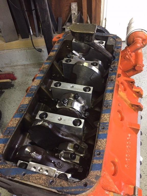

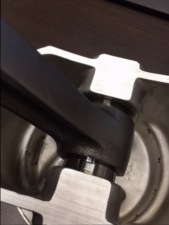

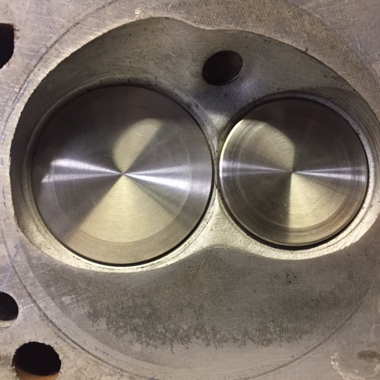

So last year I bought a used/Freshened 446 for a pretty good price of 4500 bucks. My 66 Satellite is coming back from paint in the next couple of weeks so I thought I would start getting the drive train in order. I decided to pull a head and oil pan to inspect things and see what was actually in there. At one point someone installed billet main caps on a factory steel crank w/64 max wedge rods (1.094 ends) along with Wiseco 11.25:1 pistons.
My questions should I be installing a girdle before reassembling? Not really sure how much power this motor will make but I assume it will be over 600hp.. This will also require changing the already installed ARP Fasteners for the main caps. Is it worth the headache?

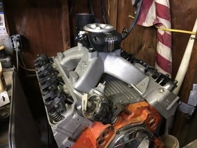

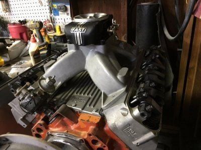

Engine specs:
  • 446 CID Factory Steel Crank
  • 64 Max Wedge rods, lightend, Balaced, and bushed for full floating pins and spiralocs
  • Billet Main Caps
  • Ported Indy -1 Heads 1:5 rockers
  • Indy 440-2 Intake
  • Comp Solid roller
    • .278/.281 @.050 Dur
    • .681 in. / .660 ex. Lift
    • 108 LSA
  • TTI 2"-2 1/8 Stepped headers
  • F.A.S.T Sportsman fuel injection

You already have aluminum caps, a girdle with your current set up may require some machine work (from looking at it, hard to tell from pics). Run it the way it is and call it a day.

Well, if you change the main cap bolts/studs you'll need to align hone the block again. It won't be "expensive", but you'll have to take the motor apart down to the block & put it back together. Tough call....
What were the center threaded holes in the caps for?

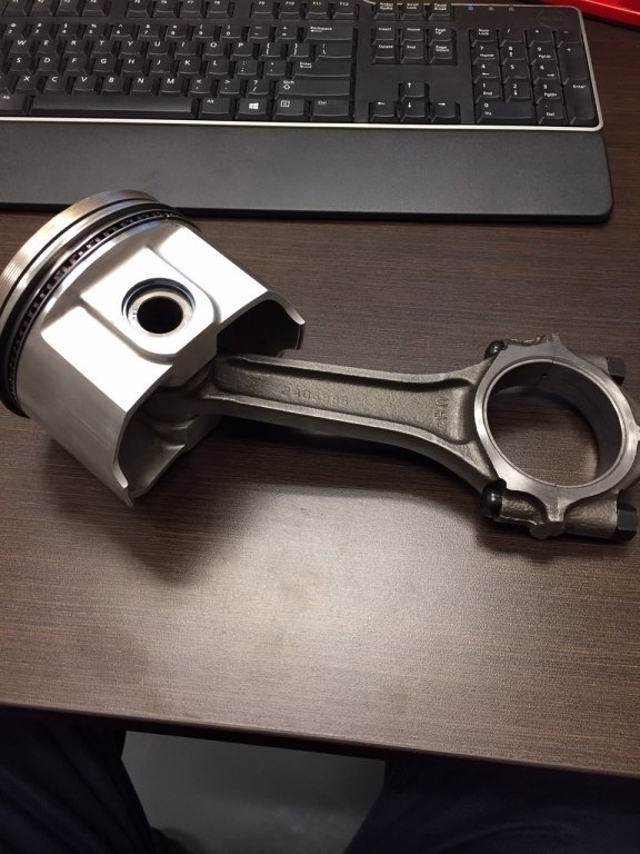

if I was going to change anything on that motor it would be the rods. And it's pretty easy to throw out suggestions from a keyboard whet it's not affecting anyones wallet but yours.. lol.
That's a pretty stout upper end and would surly support a bigger motor in the future. Run it as is for now and have some fun. I would limit the rpm's to a reasonable level though, with that upper end it's gonna want to rev higher than I would take them 53 year old rods.

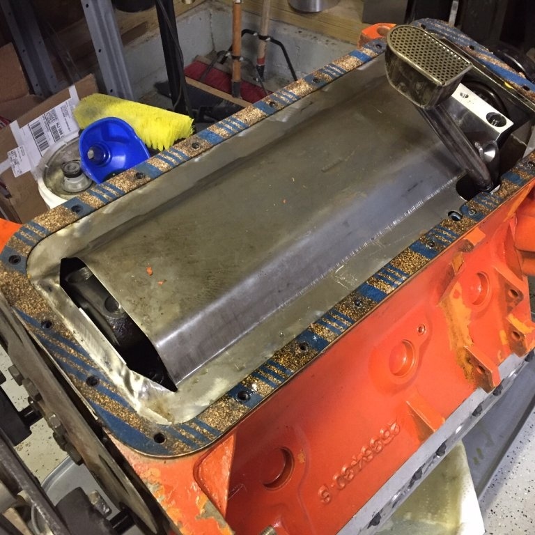

My engine builder and I decided not to run a stud girdle on my 493 build. Had to ditch the windage tray as well due to fittament issues. BUT I'm not racing it and it's only driven on the street with short burst of full throttle. I would just run it the way it is and do it later if you decide to rebuild it.

I would change the rods for sure!
are they max wedge port - 1 indy heads?

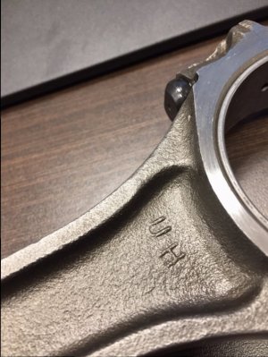

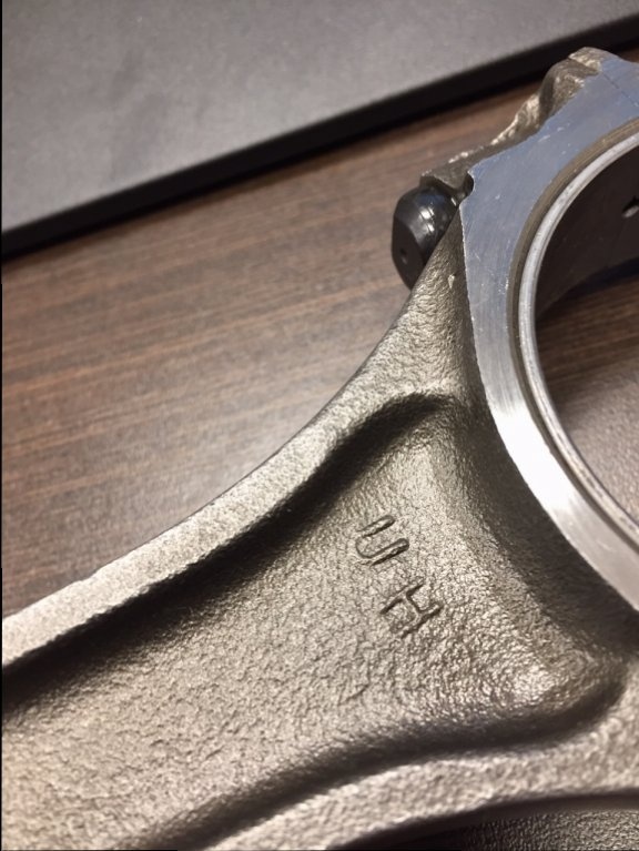

This motor has been together and running for more than a few years in a 68 RR. The only reason it was Freshened up and everything checked was the valves needed attention. As far as the rods go have you any experience with these particular rods? Swapping out rods is not in the budget at this time for sure. They are not Standard LY's

Does anyone know how Max Wedge rods compare to LY or Six pack rods?
