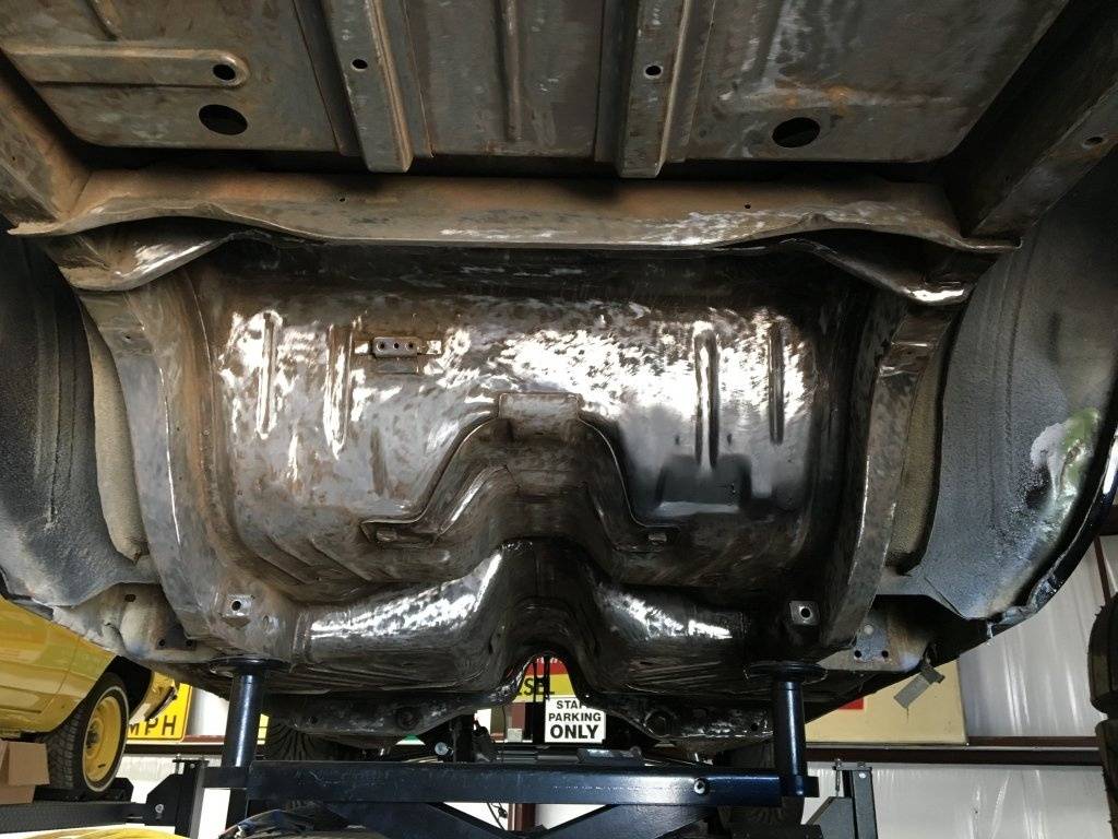

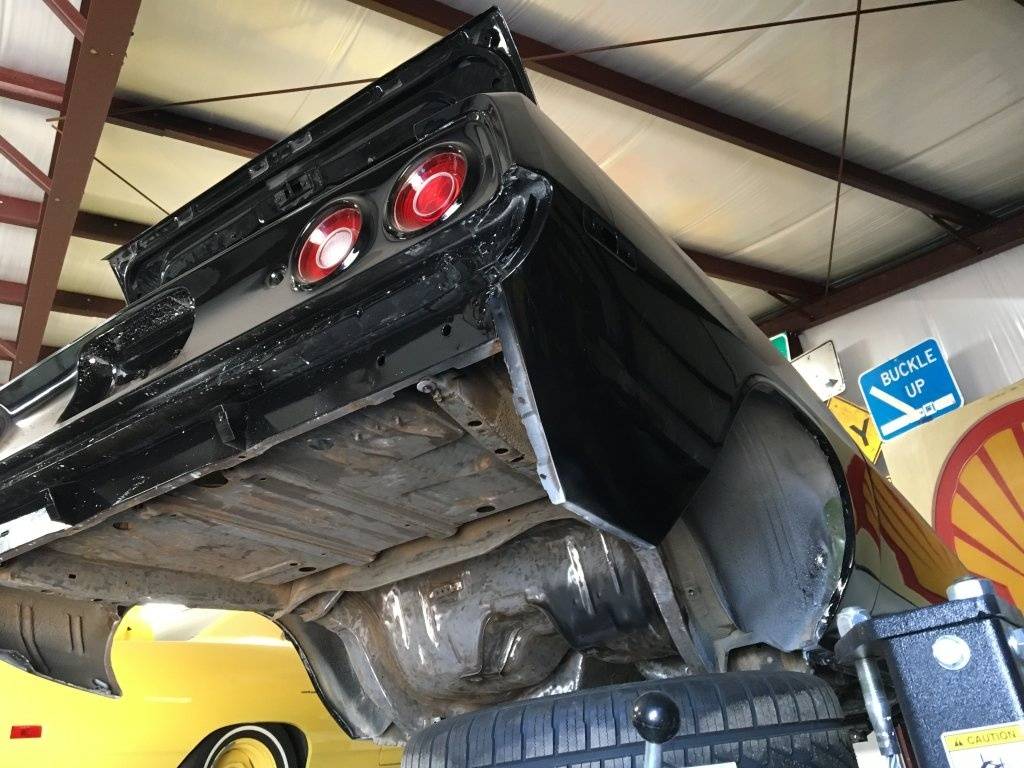

Removing undercoating I use MAP gas and scrapers/wire brushes/picks...Quick and effective...
Outer sheet metal(fenders, quarters etc) I use propane.....
Works great
