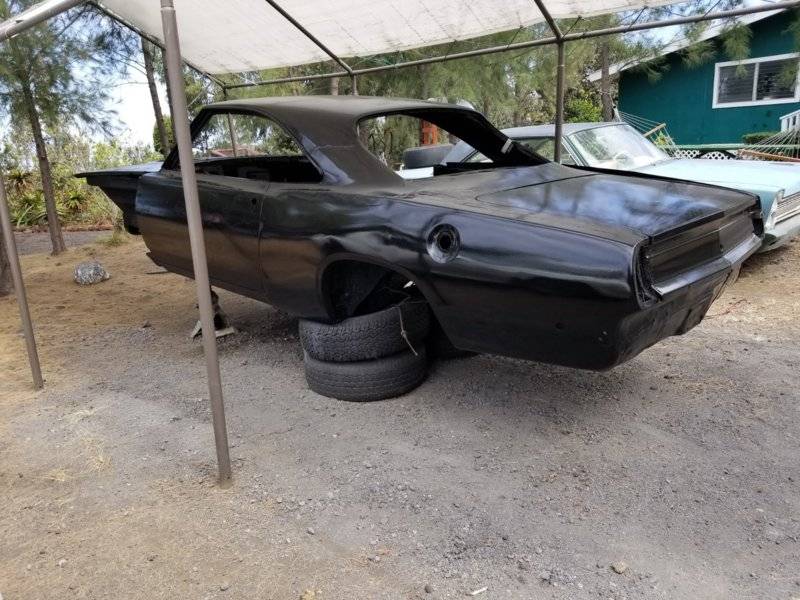

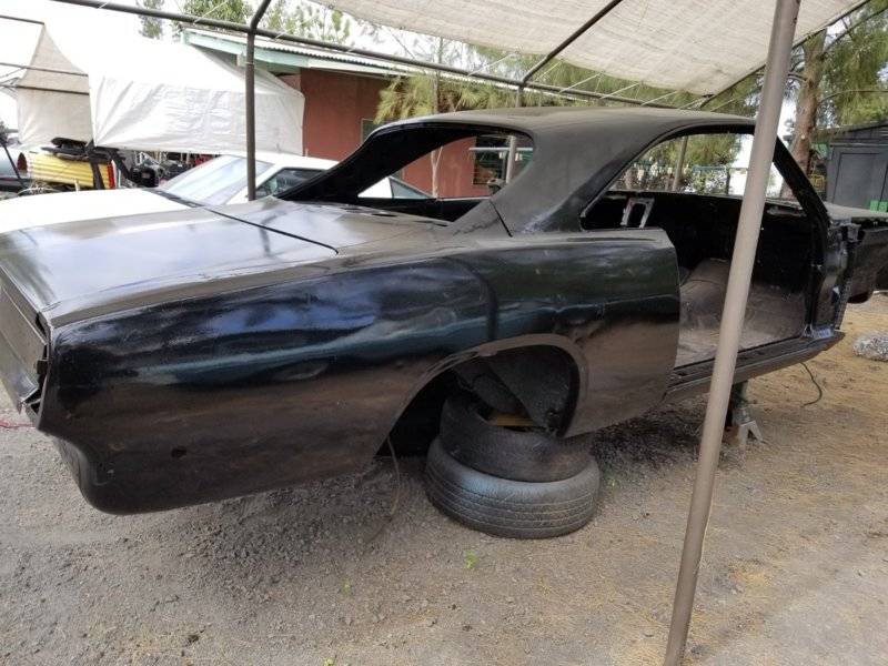

I'm buying parts for the 2019 portion of my 66 Barracuda re-furb/restore. I took advantage of the Layson's Fall discount and ordered the rear quarter skin. Truthfully, I never considered gluing, preferring to cut and weld old school. The car is in storage til March, so I'm asking for opinions on how best to attach. The car is a "keeper" for me, so I don't want any regrets
