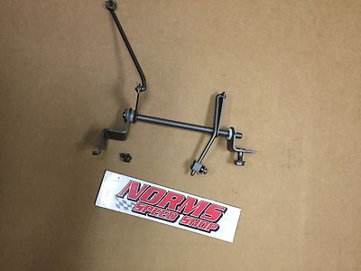

Here are a couple linkage sets on ebay. One says its for 904 and the other says for 727. They look similar to me but there must be a difference. Others here can probably tell you more.
I can't answer your question but i can tell you for sure, those parts you posted are for a833 manual 4 speed transmissions and definitely aren't what you need.

Thank you I've been looking this up for a while and getting nowhere that looks like what I need.
Here's one for sale by a member. Doesn't say if it came off a 904 or 727 though but you could ask.
