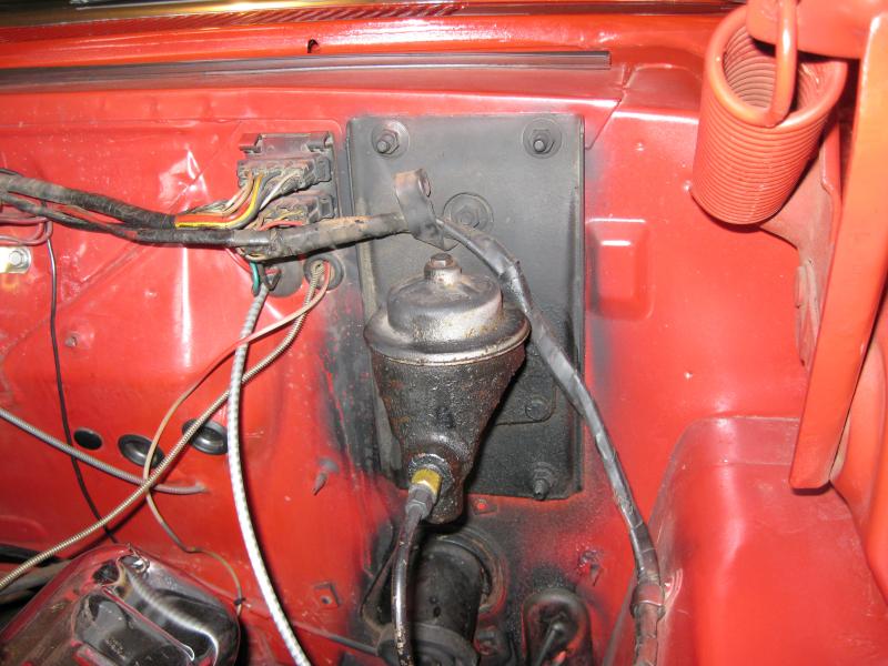

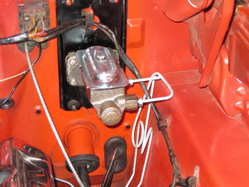

the aluminum 15/16" from dr diff works great!
