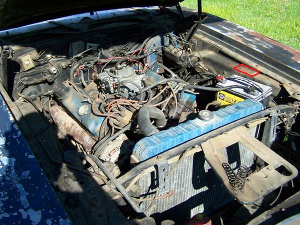

It has a 73 front bumper and grille and rear taillights and the interior is trashed but it does have a big block and it looks like it has power Disc brakes.
I don't know where the fender tag would normally be, but in those pics I can't see if there is one, would it be behind the battery in the one picture?

Also has 73/4 rear tail lights. Tag should be on the inner fender well right above the battery. Can't really tell if it is there or not.

Ok, so the fender tag should be in the red box area I marked?
Sorry, I'm a Chevelle guy, just don't know Mopar's.
Yes the tag should be where you highlighted in red.
I can't tell if the front bumper is a 72 or 73/4 but those are defiantly 73/4 bumper guards.
Disc brake were an option in 72, standard in 73. Does have a disc brake master cylinder.
