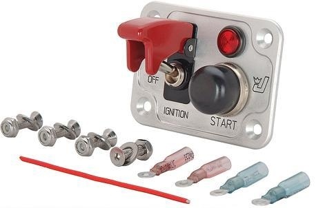

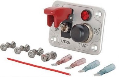

You mentioned it's a race car only. Like to see some pictures. You can hide an MSD rather easily. Inside, under the dash is a good place but as several have mentioned, the starter button/toggle switch works very well. Get it spinning first.
On an E body it's easy to install a decent appearing switch panel where the radio goes. I made a sheet metal deal that I painted semi flat black. It used the rear radio mount and slid into the radio hole. I used six smaller toggle switches which were fine as I didn't have or need gloves. What's pictured works with or without gloves but unless it was inside the console you couldn't hide it.
