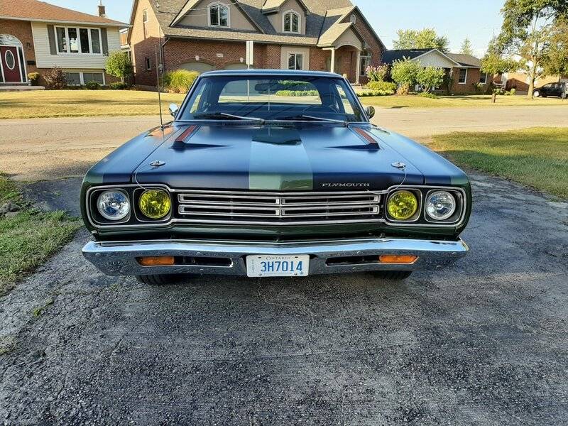

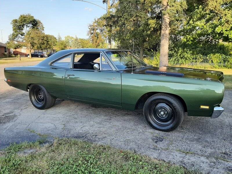

I have a 69 RR Clone with a 440 - 4 speed. I have developed a vibration between 40 kms and 50 kms. I can feel it in a turn whether it is right or left. I haven't had it before. Car just recently was upgraded from Fiberglass fenders to new steel and new steel hood. This is the only change. Wheel bearings were done 18 months ago. Last night I jacked the nose and noticed a little play in the up and down. I would say the passenger side felt like it had about a 16th to and 8th of play while the drivers side was considerably less. I did not notice any play in the steering. Attached are some pics..... Looking for some insight from more experienced people.
