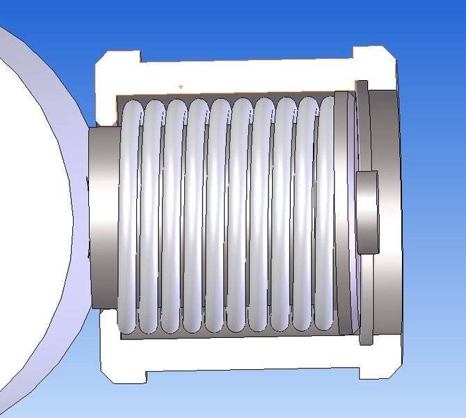

The governor is key to adjusting shift points at WOT but details of how it works are pretty poor from what I've seen. I thought I would try to understand it better so I disassembled a spare one, weighed the pieces, measured the spring and modeled the physics around how it functions. I then used that info (4700rpm unit) to predict what would need to be done for 5600 rpm and that matched a known 5600 rpm design pretty closely.

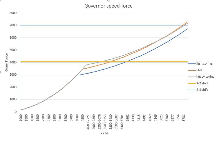

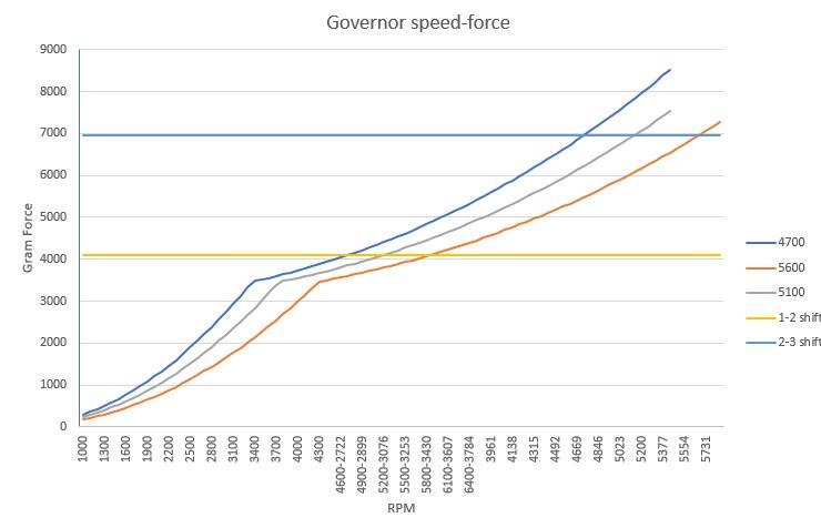

Below is a graph of gram force generated by the governor for 3 designs with known shift points. Note that changes other than the governor that change shift points will push these around. the governors will continue to be proportional to each other though. Pushing the 4700 rpm unit up 100rpm would also push the 5600 rpm unit up about the same amount.
The differences between the three are only in the mass of the inner and outer weights. The spring remains the same. Changing the spring can have odd results, changing only one weight can have odd results. If you aren't careful you'll move one shift point more than another. In fact without it modeled out it's almost guaranteed.
The lower part of the curve is a combination of inner weight, outer weight and spring weight. The upper part of the curve is primarily inner weight and less so, the spring rate. As you can see, changes to only the inner weight or spring will affect WOT shifts but have little effect on the part throttle shifts. Changes to the outer weight will affect part throttle shifts and won't do anything to WOT shifts.

I used road speed because it’s continuous. Tougher to make a chart with engine speed because it has 3 different sets of X axes. I’ll see if I can find a better way to display it. Of course the tranny doesn’t know what the rear axle ratio is, just shifts based on driveshaft speed. I happened to use 3.23 just because it’s common and what I’m working with.
The part throttle aspects are still dependent on the governor but very dependent on the throttle valve position and spring. It’s quite difficult to guess at those. WOT is super dependent on the governor and the throttle is bottomed out so many variables come out, making it more predictable.
Being that the lines on the graph are pretty proportional the whole way up, meaning the WOT shifts for the outer ones are 47:56 through most of the curve. The shifts would follow the same pattern. A part throttle 1-2 shift that was at 25 mph would move 56/47 up to 29.7. This assumes the curves keep the same shape. If you mess with the spring too much or the weights disproportionately it could move the part throttle shifts more or less than the WOT.

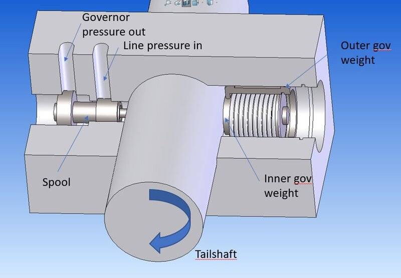

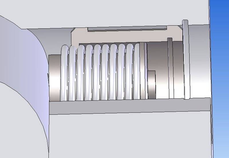

A clarification of how it works. Line pressure in, 50psi idle, 100psi WOT goes past the right hand spool diameter to the middle of the spool. The area on the "governor pressure out" is greater than on the "in" side so it pushes the valve shut. As the output shaft spins, the weights pull away from the shaft, providing pressure to reopen the spool. As the force increases the system comes to a new equilibrium at a new pressure. The higher the force, the higher the pressure.
When it starts the weights are pulled up against the output shaft.
As it spins faster the force increases for a long time, eventually the outer weight pulls away from the shaft and the spring compresses beyond its initial preload. Soon thereafter the outer weight bottoms out on the snap ring. The full force of the outer weights contribution goes flat at that point.
The force of the inner weight continues to increase. It moves just a little bit though. It's the force that regulates the pressure not the physical motion per se. Eventually the inner weight bottoms out as well. The force provided by the whole system is enough to drive the governor pressure to overcome line pressure and springs and force the shifts.
This is good information. In my book I'd be only concerned with WOT. Now we can weigh the small governor weight. Then knew what percentage of the small weight needed to be removed per 100rpm increase. Someone could simply remove the small weight , weigh it , drill it and test.

It’ll apply to more than one car but I agree, the curves get steep out there in the very high rpm so little differences go quite far. At those speeds, by my spreadsheet you better be measuring in the .05 gram accuracy range and you better have calculated what you want. Guessing won’t work. The spring won’t do diddly. Only handles the transfer from one weight to another. If you get that wrong then the weights will be much more sensitive and probably never right.

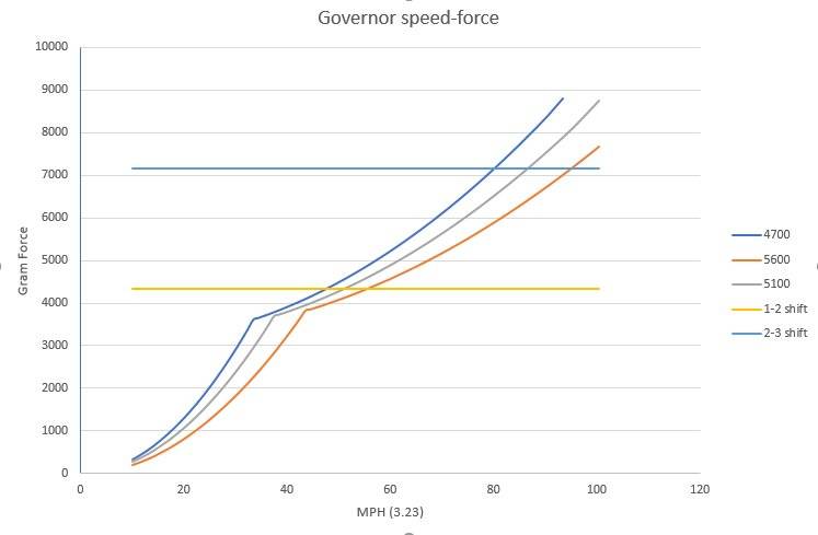

I re-did the first chart to use RPM to make it more useful.
Then I took the model, using the 5600 RPM as a baseline and messed around with the springs.
I think it tells an interesting story. The spring obviously doesn't do anything to change down low. And lighter springs = shifts later. You'll note that the curves change though. With a single spring, changing the weights can move around the shift points in a fairly even fashion, where you started will be proportional to where you end. When you change the spring though the trajectory changes, one shift point will move farther than the other. If this is corrected for, further weight changes will have relatively linear behavior but additional spring changes will disproportionately move the two points. This bodes well for tweaking an existing governor but not so well for "one size fits all". That's why sometimes the A&A governors will throw the two out of whack and require a changed 1-2 or 2-3 shift spring.
