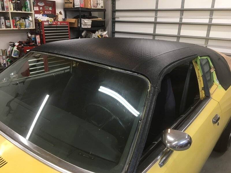

Welcome. I'll chime in on the vinyl top question. Depending on your skill level, from what I've read, it can be a fairly straight forward job. For me, I am having someone with experience accomplish this task. I purchased a Legendary vinyl top and it appears to be very true to the original pattern and color.
The thing that concerned me was the removal of the windshield and back glass. This is not something I wanted to risk screwing up. Good luck and post photos!!

No need to remove the glass to install a vinyl top on a 73-74 Charger which I assume you have based on the pic. Pull molding and clips, order a new set of clips. They are slip on so they can be replaced with the glass in place. Legendary for the top. Matt finish on the stripe.
