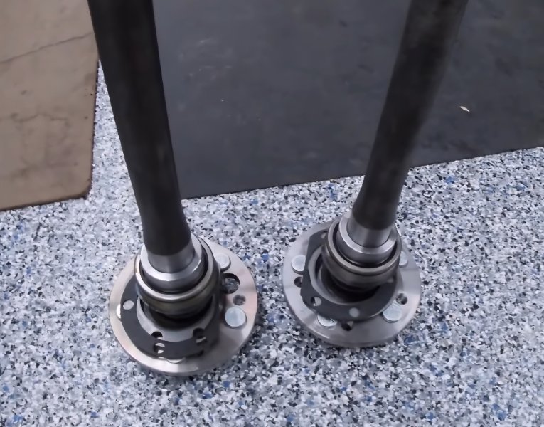

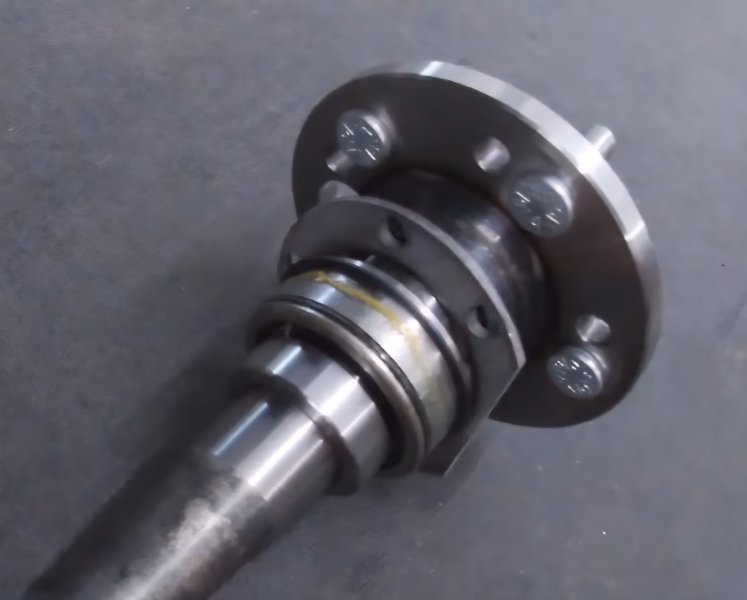

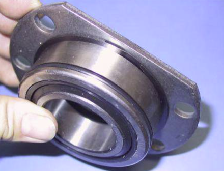

I’m currently running green bearings on a 8.75 rear.The other day I noticed a little splash of gear oil on the inside of the driver side tire. Haven’t pulled the axle yet so my question is can the bearing be cleaned with solvent and if so can it be re-packed? I’m thinking the rubber o-ring is leaking. Anyone know the size of the o-trying?

As far as I know they are a sealed bearing.

They're sealed. It's far more likely the axel seal (behind the bearing) is leaking.

So if the bearing is sealed there’s no chance of the bearing being washed out with gear oil?
Unlikely, unless the bearing has failed and the seal is broken. However, there are only a few ball bearings in that bearing, so when the seal fails - which is part of how the balls stay in place - the bearing gets pretty loud. In other words, when green bearings fail (in my experience) they fail fast. I put green bearings in all my cars, so I'm not downing on them.
One more thing... there is the seal and then there is the o-ring, which is just to catch the little that might slip past the axel seal.

That’s what I thought

The whole bearing and axle is held in by that snap ring on the green bearing?
Some don't put in the inner seal when switching to green bearings, relying on the tiny o-ring.
No idea if the o-ring is reliable or not, but I put some grease on them and always install a new inner seal for some insurance.
