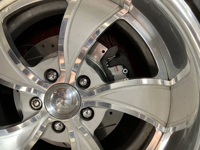

I made the rear disc swap in 2006 entirely for the looks of them. Drums were clearly visible through my rear wheels and to me, they looked cheap. The disc brakes looked like performance so that is why I bought mine.
Doctor Diff sells a variety of brake and suspension parts, I got my brake kit from him. The kit I got did NOT require the "Green" bearings, I needed wheel bearings anyway so I gave them a try. I wore out the first set in about 8000 miles. When this second set go bad, I'm going back to the tapered design.

My Dr Diff rear (Mustang kit) discs are installed with tapered bearings and work very well. I would recommend keeping the axle clearance at the minimum of the range. How much fluid volume would .008" of piston movement cause? I can't believe you could even feel the extra pedal stroke to cause the pads to close the .008". And you have superior bearings!
