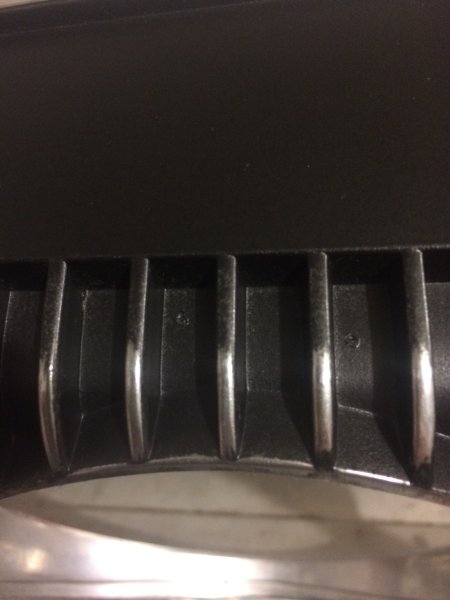

Has anyone painted the blackin between their grill teeth? Im looking at mine and it needs paint but I dont think spray will work well it would paint the chrome. Especially the back side of the headlight buckets they are a mess.

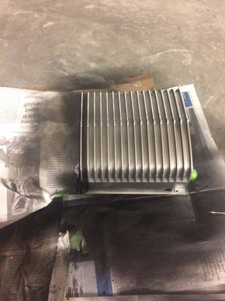

I sprayed mine and then carefully removed the paint from the bars. You could tape every one if you have the patience and time
Took a while to complete!

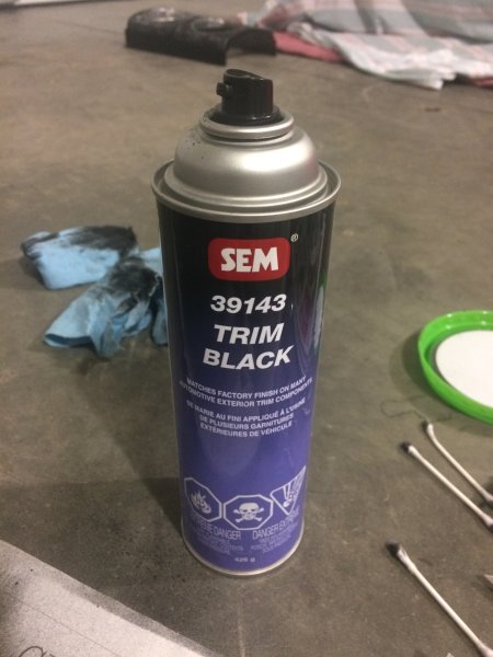

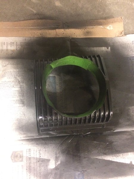

Have patience, set aside a decent block of uninterrupted time, and enjoy the process. The grille on these cars is part of the magic. I taped off the back, used an etcher, and then sprayed. Use lacquer thinner on a Scott towel (or q-tips) and gently remove overspray from chrome parts. The face of the splines. Turned out great, fairly easy to spray in the sides this way. Try a test or smaller piece first.

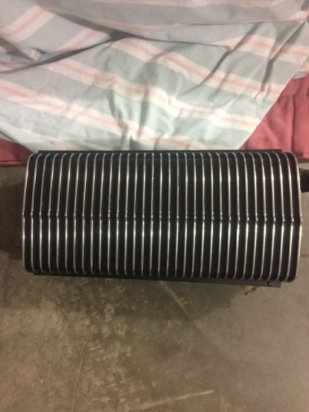

I did this on mine about a month ago. Worked really well and gave a perfect result. Sprayed with satin black. I also painted the rad support black behind the grille to add to the "floating" look, as mine was red before.
