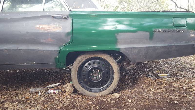

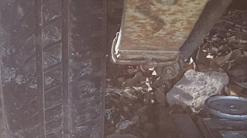

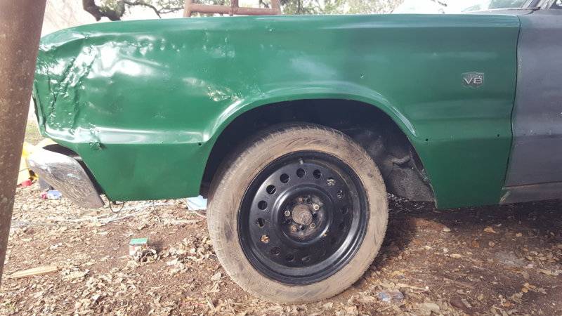

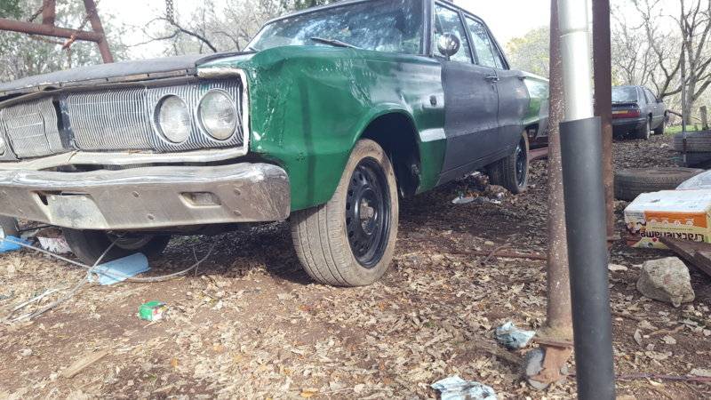

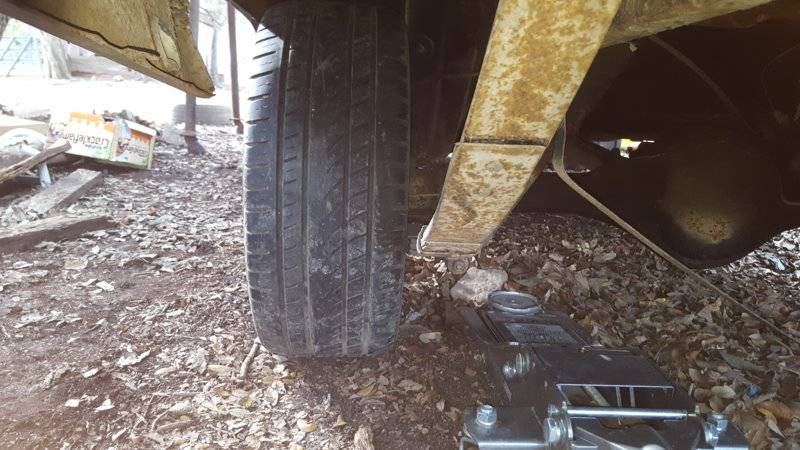

Tire fitment trying out 17x7 rims with 245/45 17 I had take offs from another vehicle. Got 1/4" of space between sidewall and leaf spring. Not sure on the front though as I havnt cycled it through its range.

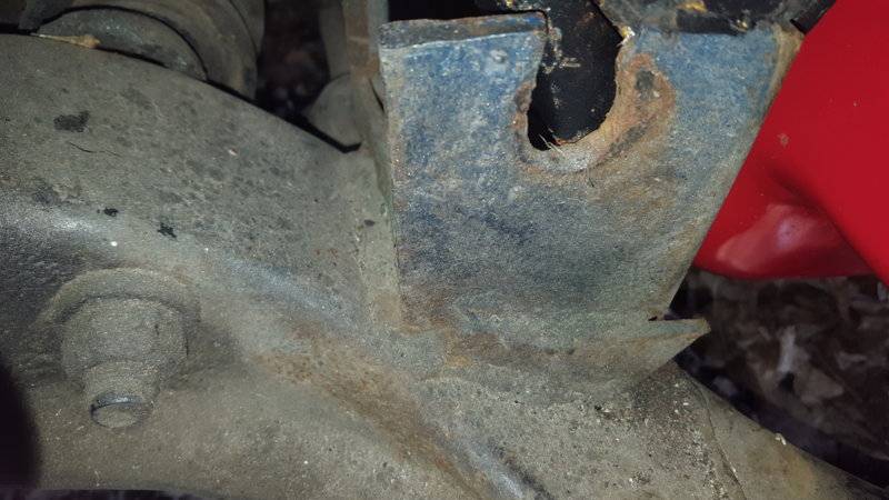

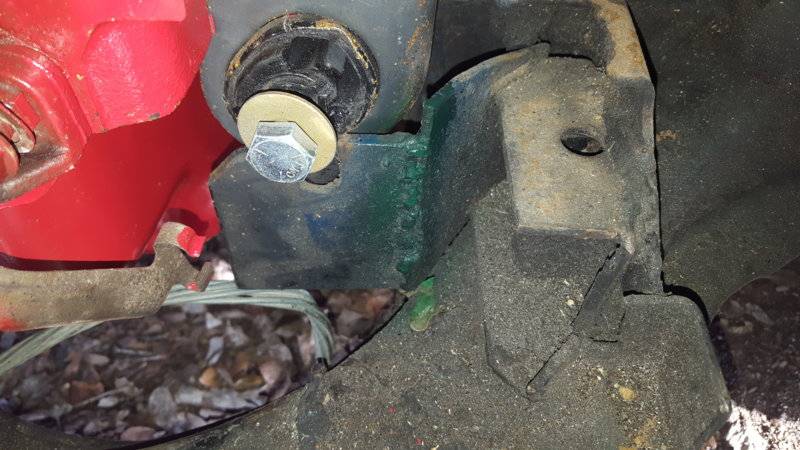

P.O.'s motormount perch hack driver side needs to come forward and to the right 1/4". Passenger side needs to go back where it was.
Driver side
Passenger side
