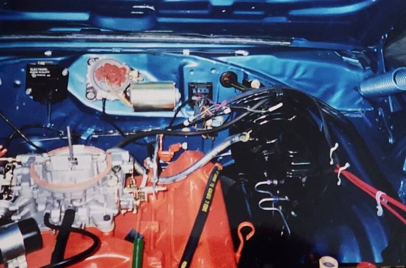

dadsbee, so those are factory original lines going to the master cylinder?

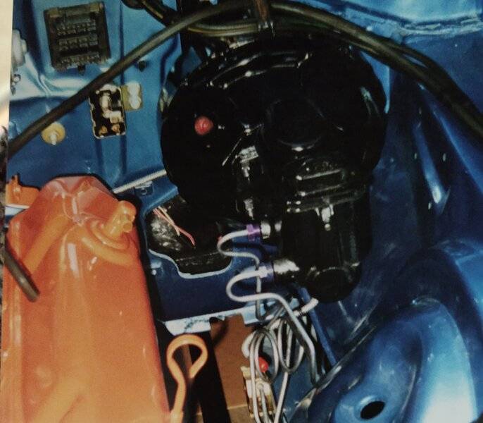

I believe colored fittings are correct. The attached pictures are from my first 'Bird, back in the mid 90's. I purchased the lines as reproduction factory originals. The front fitting is blue, it appears, and the rear was purple. This is a 1970 with power discs in front, drums in the rear.

I have never seen colored fittings on brake lines, and I have been playing with old Mopars since I got my first 63 Plymouth in 1972. I have worked on, and scrapped, a bunch of them over the years.
My '67 factory fittings have no color coding. Took off originally master cylinder when I changed to front disc's. That was the 1st time a wrench had ever been on the fittings.
Thank you everyone for your input and pictures. I am striving for as factory correct as practical so I think I will investigate the feasibility of stripping off the coloring before installing.
I have to admit that the coloring is sort of cool looking. If I were doing a resto mod or just fixing a daily driver I would be inclined to leave it as is especially since practically speaking the only fittings that are readily visible are at the master cylinder.
