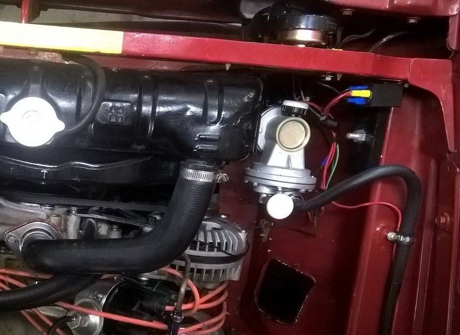

I had to install a vacuum pump plumbed into the brake booster.
It is an electric one. You can feel some vibration when is running but soon kicks off. Hope this helps.
I have an electric pump that I paid over $250 for. The pump is connected to the vacuum canister and the canister is connected to the power booster.
