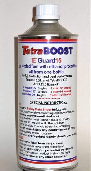

Was just able to purchase this:
https://www.ebay.co.uk/itm/TetraBOO...ded-fuel-with-ethanol-protection/254635058356
So the problem is solved for now.

Tetraboost recommends to add 100ml to every 11.5L of unleaded gas.
What do you guys think? That would cost 25 bucks each time filling it up.
Do i really need to add that much? :)

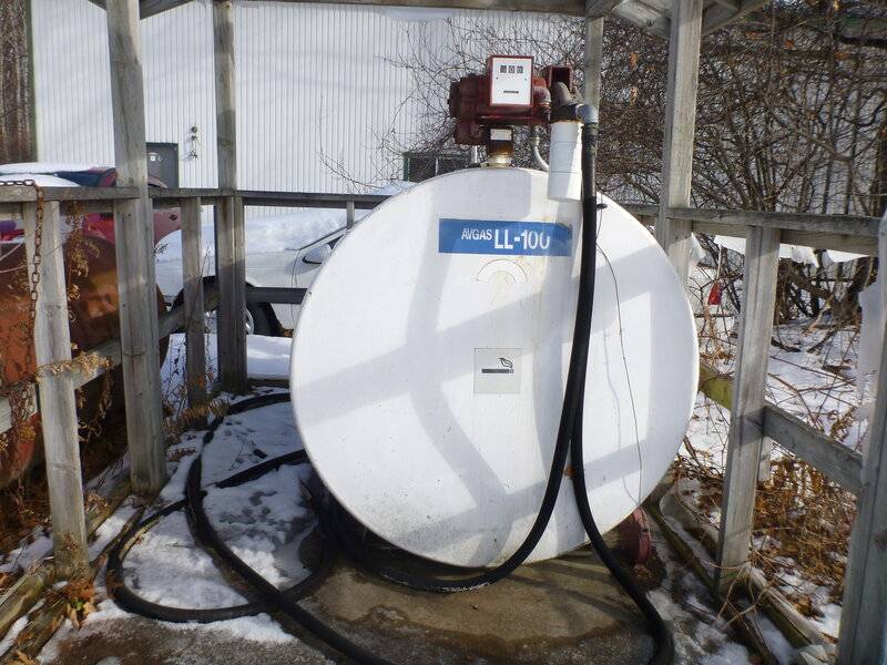

I run about 15% AV100LL, so 3 or 4 gallons to a full tank of Shell 92. Jerry Hall runs 50/50 in all his classics without issue. I use it for lead and an octane boost for my 383 and 440HPs, but I don't have to go more than 100 feet to put it in my car.. :D
That is a good mix ratio. Higher does no harm but is unnecessary.
I love the way Shell advertises 92 octane at some pumps, but it leaves the refinery at 91. Must be magic in the tanker.
This thread reminded me to call Hammond in the morning to get my 500 gallon tank refilled!

https://www.ebay.de/itm/TetraBOOST-...ded-fuel-with-ethanol-protection/254635058356
But this is pricey. Do i really need 100ml for 11.5L of pump gas?
A couple of points here. If you use 4 gallons of 100LL Avgas in the tank when you fill a B Body with premium unleaded, that will be decent fuel and give more than adequate valve seat protection.
As far as the Tetraboost additive, you do not know what concentration of lead is in it. You also have to be cautious comparing octane numbers between NA and Europe. Europe quotes the Research Octane number which is higher. NA uses the average (Research + Motor ) / 2.
I used to work for Sunoco, so the following results were verified in a Wakashaw Knock Engine, albeit years ago. Using Sunoco 94 (99 research octane) as a base and by adding 2 grams per gallon of lead, 102-103 research octane was achieved. The amount of tetra-ethyl lead that would be required to be in the TetraBoost container to achieve the results they claim would make it highly toxic. Too toxic to ship and handle. I suspect their claimed results are optimistic at best.
Excellent example....too many people are looking for a panacea in an easy (?) to use product, without any research ..... especially taking the word of the manufacturer whose product is soliciting your $$$ donation. WHAT IF after using their product, and it does not perform to their or your expectations, say an exhaust valve failure or seat issue, will they reimburse you for the repair costs and refund price of the product. What is their liability?? This info is NEVER included in the description of the product or in the concentration to use, only how great the material is..... Also, be aware of the MANGANESE COMPOUNDS added....these compounds are death to spark plugs. As the old expression goes: "Let the buyer beware" applies... just my opinion of course.

Well as far as Tetraboost i will follow the instructions.
I hope it contains enough lead to protect the valves.
At least it contains real lead and is not a substitute like almost everything else.
After i used it up (already ordered 6 cans) i will most likely switch to AVGAS 100LL as its available locally.
