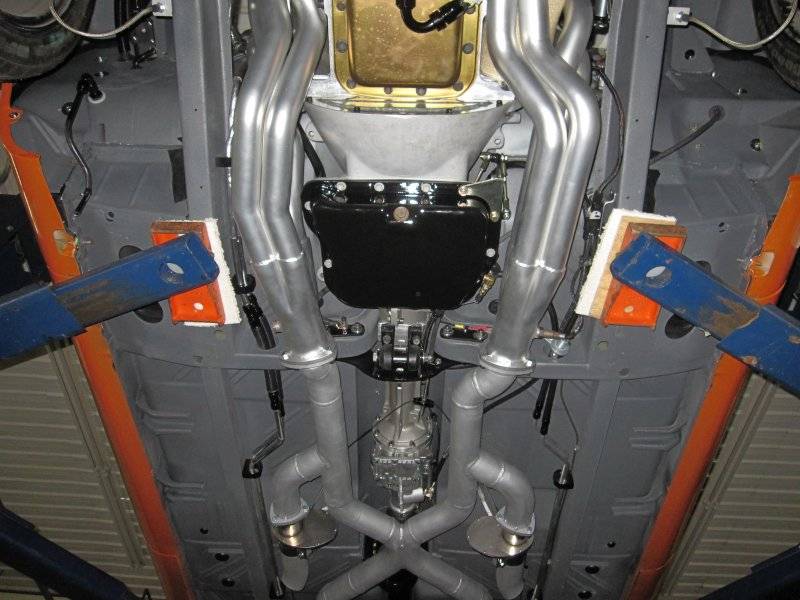

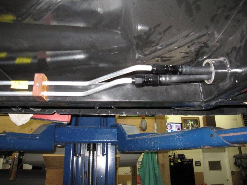

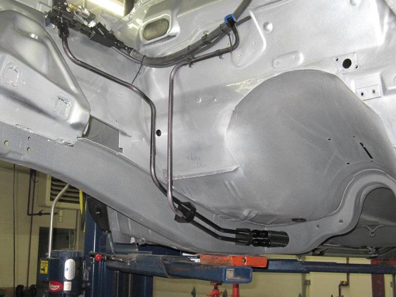

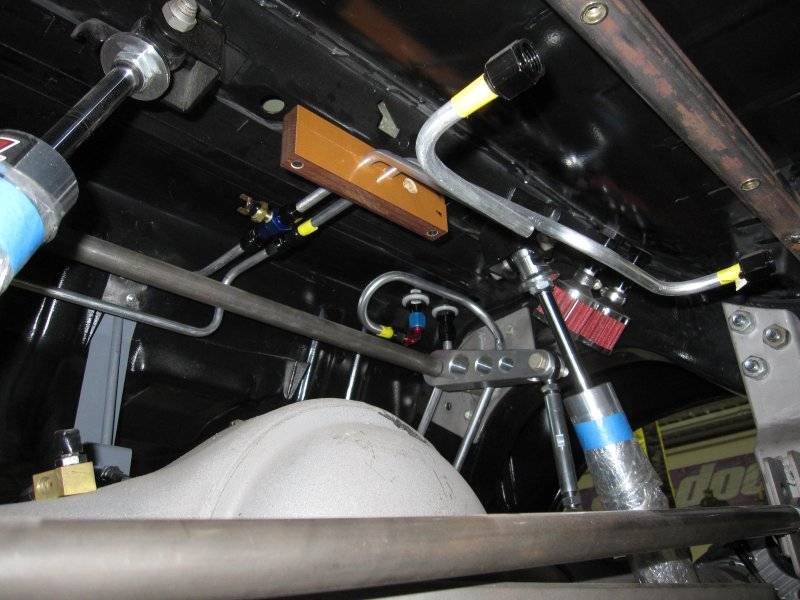

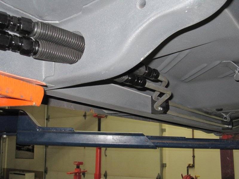

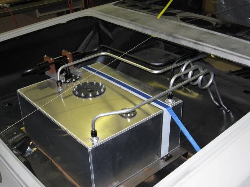

I did the same routing on my 65 on both sides, fuel and transmission cooler lines. Photos were taken at different stages of the build.

Mike. your execution and attention to detail is admirable. I only saw one very minor detail I would do different and will reframe from publicly noting it in deference to a job well done. :thumbsup:
