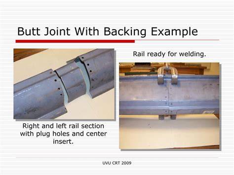

If you section it you could not only butt-weld it in, but also make a sleeve and plugwelds also.
Like this:
The benefit is you leave a lot of factory welds in place in the areas that are still good. It’s less invasive.
