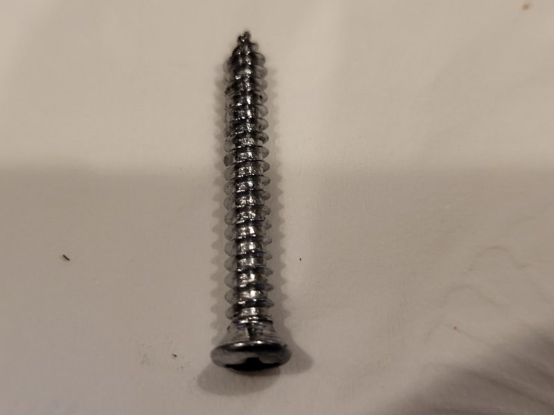

What do the screws look like that are used on the interior trim around the sides and top of the rear window on 2dr hardtop (GTX, RT, Coronets, Belvedere and Satellites)?
Pictures would be great.
Thank for any replys.
They are pretty common oval head screws - chromed - #8 I think. Need to be cautious on getting the correct length.

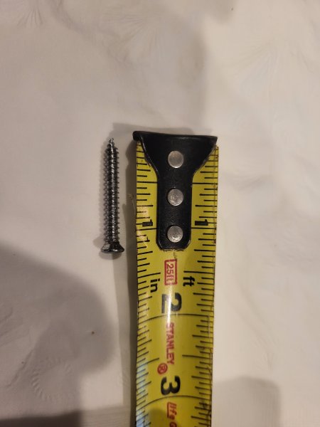

Looks like 1 1/4" long
