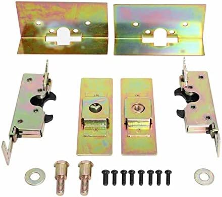

Has anyone here installed a set of bear claw
latches?
I've browsed some hotrod sites and some of
the methods they use seem to be a little a
little bit of an overkill.
I don't see the need to cut out a large area in
the door just to weld in a reinforcement plate.
These doors are not very heavy.

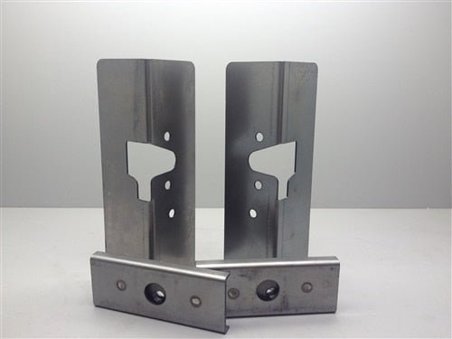

the top picture with the reinforcements are a guide of where to shape the sheet metal as well?
Do you have access to the inside of the cab for the plates for the pins?
Yes to both questions.

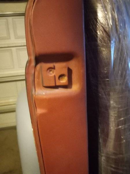

This is a pic of the old striker.

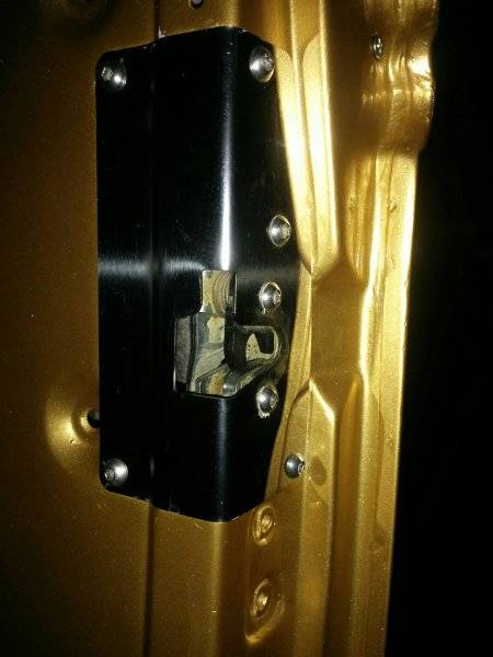

I used Altman Latches by Trique Manufacturing on my 40 Ford Pickup. They make a specific application for
my truck but they also make a unviersal set of latches and plates. Nice quality.

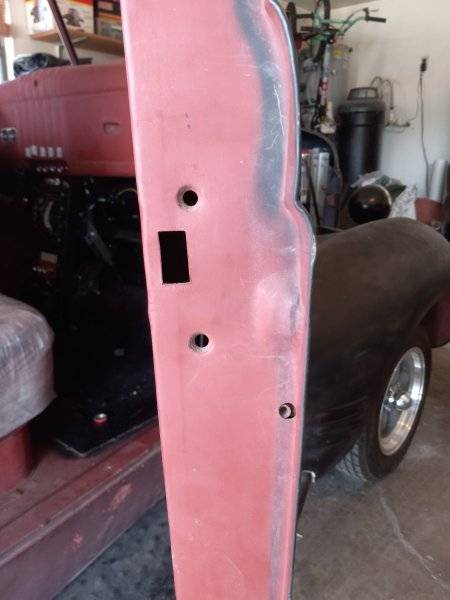

I don't see the need for the big heavy bracket
when the latch can be mounted directly to
door, and a notch cut for the post on the B
pillar. I'm pretty sure there's enough space
for the latch to fit between the inside surface
of the door and the window channel. Have
you got a pic of the post attached to the B
pillar?

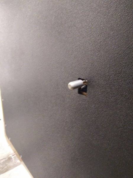

I believe the guide plate adds strength and helps locate the latch. That being said, you are the judge of whether or not extra strength is needed and locating the latch with a universal set up is no big deal. Thanks for the compliments. Dupont Pacific Gold.
I ran a cable set up from Juliano's.com for the inside actuation. This all required a lot of adjustment after I added door weatherstrip a few months ago. A pic of the door handle knob.
