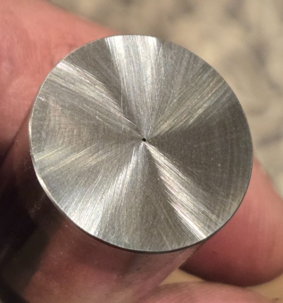

See if you can see or measure the crown? Is it to a point in center or a radius side to side. That is where I’m sending mine.
It looks like it goes to a point. I'm basing this off of using a steel ruler across the face against a light source. I don't have feeler gauges in the house to measure it right now.
If so I’ll try surfacing them on my lathe with a grinder attached to post, using a very fine stone. Wouldn’t take much to wiggle the grinder to get a crown. I have a drip cup to apply a splash of oil on the end. A diamond cup stone would be great, I’ll check Goodsons
