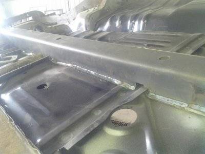

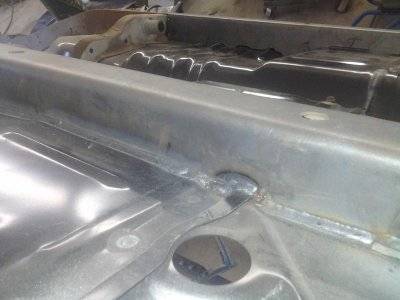

? USCartool subframe connectors welded in transformed the ride and handling. More rigid than before in the direction of a modern car.
My car was cracked at the rear frame rails, so I put in frame connectors to cure it.

Reference the stiffening issue, not sure where this stems from (other than UTG) but stiffening can only improve the vehicle assuming it is done correctly. For discussion sake, look at convertibles and performance cars from the era, attempts were made to stiffen them up somewhat to withstand twisting. It has been reported that in cars that did not have stiffening but had significant HP added in some cases cracked windshields, popped spot welds especially in the quarters and bent other aspects of the substructure. In other words, correct and properly installed SFCs, torque boxes and under fender supports greatly enhance the structural rigidity of a classic car. I install all of the above in all my builds.

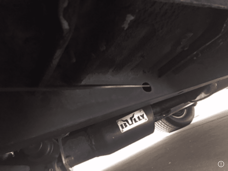

I installed the mopar performance bolt on frame connectors. I figured it couldn't hurt. The car is not a fire breather, or will see a track. I figured it couldn't hurt.
