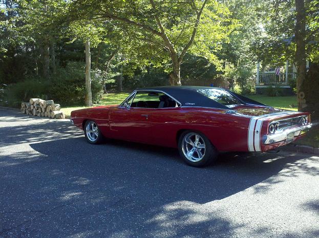

My 68 Charger is pretty low in the front... Is that the only issue with these? that they lower the car alot? if so maybe they are the right product for me... thoughts?
I already have the hotchkis rear leafs installed and plan to add bigger Tbars, FF tubular UCA's, LCA stiffening plates, ADJ strut rods, RCD bilstien shocks, FF front swaybar. It would nice to save some cashish on these bars

Sweet charger!
What motor do you have? I have the 1.06 bars from firm feel. With an all original (iron heads, intake, exhaust manifolds) they are a little light for just the spirited street driving I do.
440. Iron heads, iron hp exh manifolds, aluminim intake, power steering, aluminum rad. Not sure what bars are in there now. I put them in well over 10 years ago. I got them from mancini and remember wanting "stock spec" R/T bars as I was changing out the original 318 for the 440.
