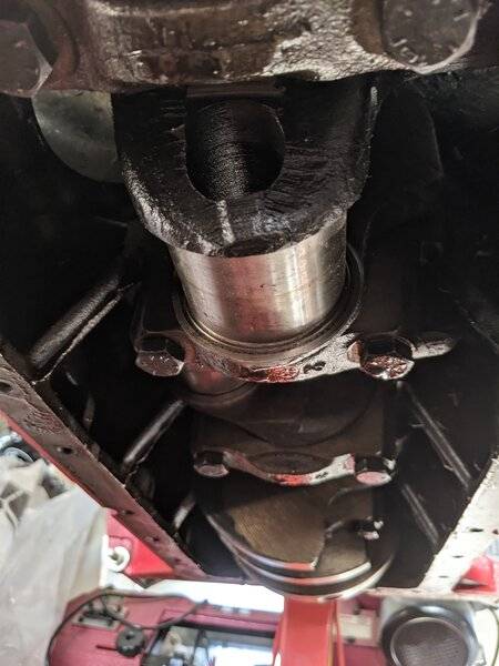

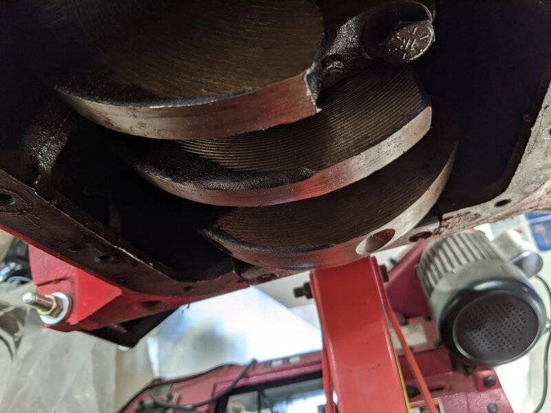

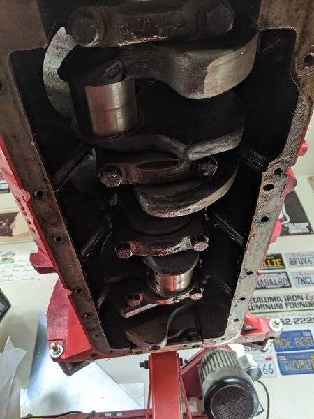

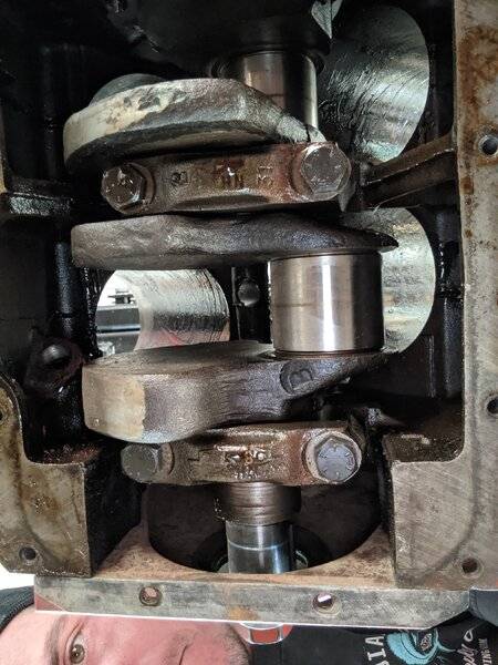

Well check which crank it is. Can by just looking at it. I think it should be steel,, but was under the impression all 6-pk rod engines had weighted balancers. Yours looks like a standard neutral balance forged crank one
So this was just a good ol bucket-a-parts? Or was it for sure 1 whole complete engine
Not sure what crank this is, but I thought you should look for the wide parting line and the rounded edges to see if it's forged?
Now I'm wondering if this was a stock cast crank and stock flat top pistons, and the six pack rods were swapped in for strength?
And I was told it was a complete engine at one time that was disassembled - it came to me in a box-o-parts (with the crank still in the block).

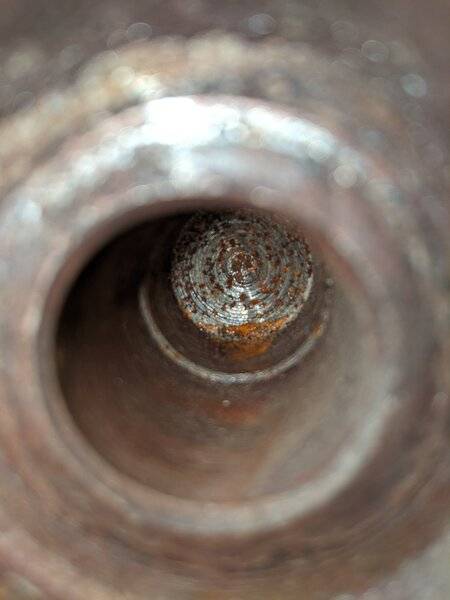

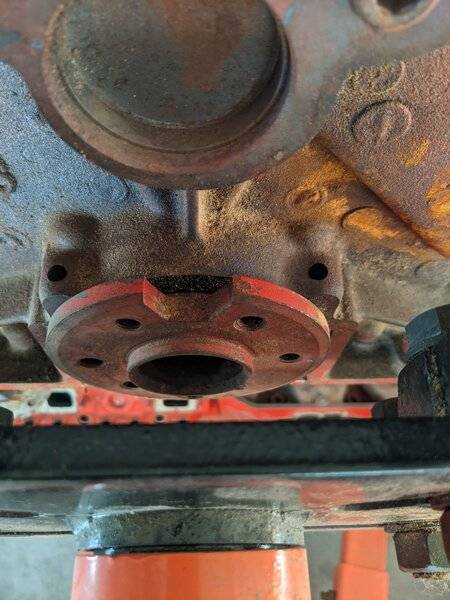

Its a forged crank.Good. And the balancer matches the block.Sooo... Did 75 steel crank 6pk rod motors come internally balanced? I don't know.
But another thing to check is if it is drilled in the back for the 4spd input shaft.
Thanks for confirming that! That's definitely good to know. The block is on a stand right now, but tried to take these pictures of the rear of the crank where the input bearing would go, seems like it's machined to accept the input shaft:
