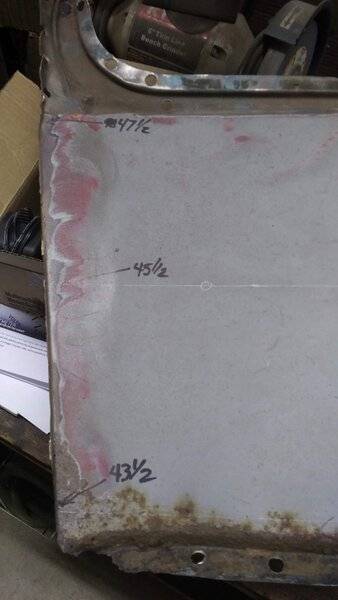

The panel I have is at least 6 years old and apparently the stamping was off. (Thanks to SGTPaul for pointing this out) It needs to be longer (left to right from the back of the car) by about 1/8 inch per side or 1/4 inch overall. (I verified this with the original rusty panel)

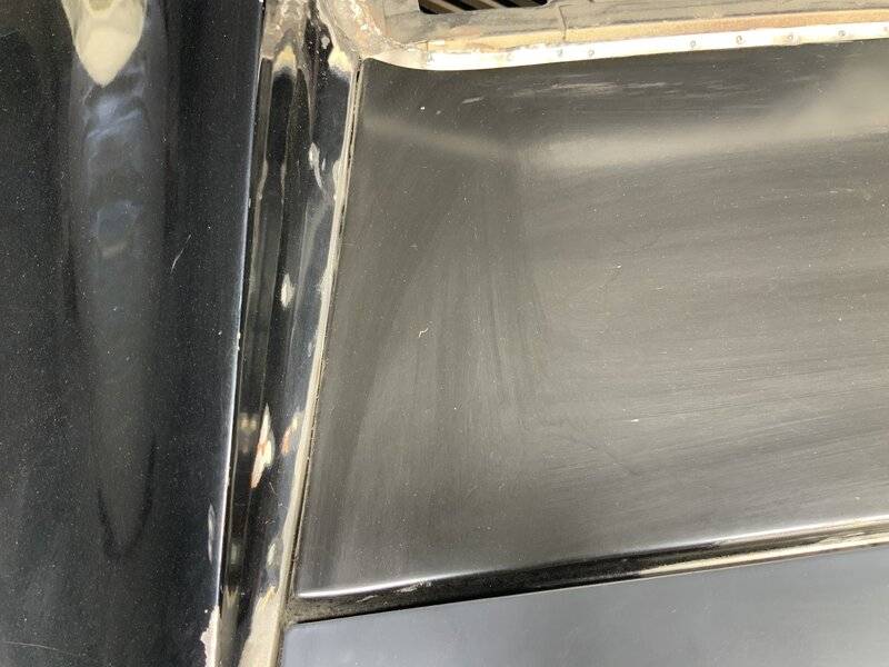

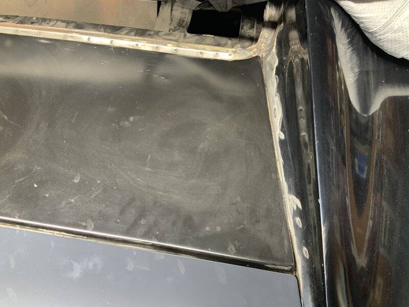

I have one i just put in can u show exactly the points u need the measurements from
If you measure the 2 longest edges that run along the rear window and trunk lid
47 5/16 does that’s sound right

I measured my original panel and I get more like 47 1/2 inches. Which is the edge along the trunk lid.
I measured down from the trunk lid edge 6 inches and 12 inches.
Then measured across the panel and got 45-1/2 and 43-1/2 inches
Why don’t u shoot Chris birdsong a PM and ask, he has done many of these and mite give u some advise. Just a though. mine looks good.
